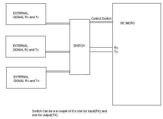

Hey guys i wanted to know what would you do or use as a solution for this:
I have 3 signals of rx/tx so we will call them
Rx_1 / Tx1
Rx_2 / Tx2
Rx_3 / Tx3
What can/should i use for best performance ..switch them to my PIC or LPC uart.
Like those 3 above are all totally different signals coming in from different places. But i want to be able to pick which to use digitally like a button and then my PIC controls a IC which selects a line to connect to my PIC..
Here is a diagram... Be aware i made this in PAINT lol

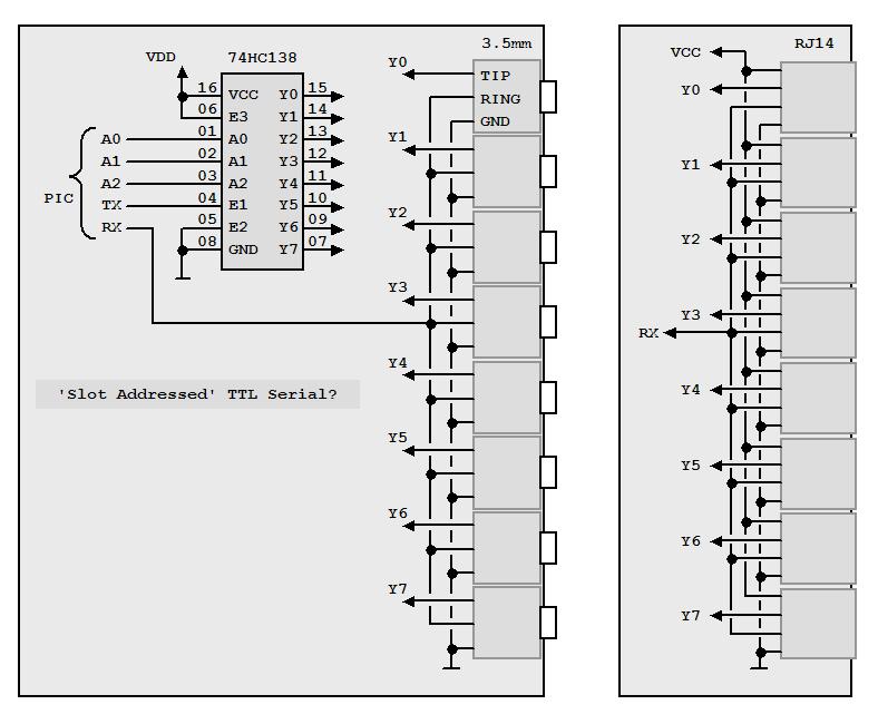

Hi Jason,
I thought about doin' it this way at one time (TTL level serial signals). It was a master/slave setup so the master RX was connected to all of the slave units (open drain) and I simply switched the master TX signal to a specific port. I also thought about using the RJ-14 modular connectors for supplying power to the slaves.
Anyway there's no reason why you couldn't use one decoder IC and one selector IC and a small 8 pin PIC to supply the A0..A2 address signals to them to select 1-of-8 serial channels. Just an idea.
Take care. Have a nice weekend.
Mike, K8LH
rs232-slot-addressed-jpg.32278
A lot of designs just use quad analog switch IC's like 4066, 14066, 74HC4066 etc. They have 4 independant switches that will allow data either way, and are fairly tolerant of spikes etc. They are common in digital port switching and are also used in VCR DVD equipment to switch AV signals to all the AV ports. 2 chips gives you 8 switches, so will switch 4 devices RX+TX.
But if your 3 target devices are not all connected at once, you can just parallel the RX and TX pins to all.
Jason,
Are the Tx/Rx signals logic level (0/+5V) or RS232 serial (+12/-12)?
Ken
