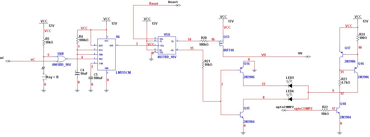

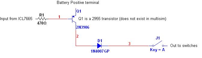

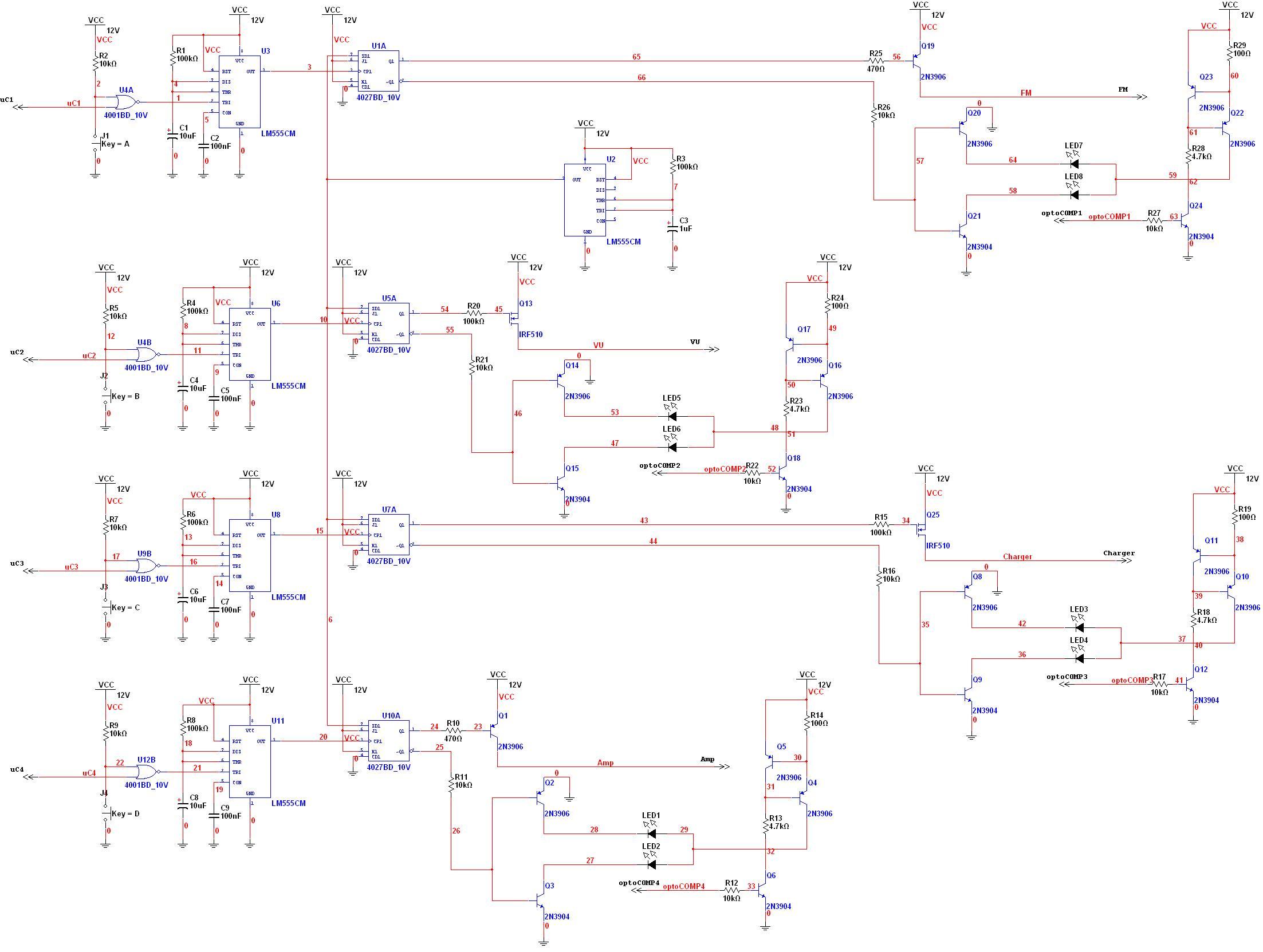

I have a PNP transistor and a 1N400X diode before the switches actually get the voltage from the battery (the PNP is connected to a battery monitor for low voltage cut off) There is also a diode from the 12V regulator that operates off of the AC wall voltage (to keep the battery from powering everything else in the circuit). I have also put a push button switch on the positive end of the battery so I can shut off all of the power to the circuit.
In the schematics I have posted the connectors that say optoCOMP# are all connected to the same photo-comparator that shuts off the LEDs if it gets too dark (additional battery saver), the connectors that say uC are where the micro-controller's input will go, each connector that says VU, Amp, FM, and Charger go to the respective portion of the circuit.
The first circuit is of the circuit before the TTL switches, the second circuit is all 4 circuits connected together, and the third circuit is just a single TTL switch.

Your schematics do not show the voltage of the battery so I guess it is 15V. Then the 470 ohm base resistor for the MJ2955 transistor produces a base current of 29mA. Then the MJ2955 will switch only 290mA well.
I do not see any "TTL switches" anywhere on your schematics.
You show an N-channel IRF510 Mosfet but the circuit needs a P-channel Mosfet.
You show many 2N3906 PNP transistor that are supposed to be 2N3904 NPN transistors. Then the pairs of LEDs can be connected in series and driven from a single 2N3904 transistor.
Why use current regulators for the LEDs instead of a simple resistor?
