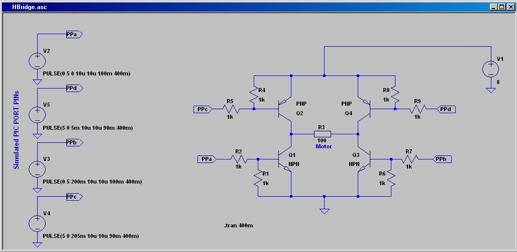

I am busy building a small wheeled robot. My problem is with the switching of the H-bridge. I would like to run the motor from a 8V power source, and the pic from a regulated 5V source. It is in other words, 2 seperate circuits. I am now busy with the prototype on my breadboard, when I ran into a problem. I am using 2X TIP102, and 2XTIP107 transistors, with 1K pulldown resistors, and 1K resistors on the Base. The motor pulls about 1A full load, and 100mA free running.
When I connect the bases to the 8V supply, the motor starts, and runs perfect, but when I connect the bases to the 5V supply, the motor also runs, but the transistors heat up instantly (smoking hot):eek:. I suspect that I am doing something fundamentally wrong here....

I'm going to bed, but I'll try to anticipate your problem. The PNP devices in the top of the HBridge are being driven with a 5V output from the PIC, when the PIC's vss is tied to ground. That means that with respect to the emitter of the PNP, the base is driven either to -3V or -8V meaning it is always ON! That is why it gets stinking hot.
You will have to use an additional transistor stage as a level shifter to properly drive the bases of the PNPs. The NPNs are fine as they are.

Here is the working version of the PIC driven 8V H-Bridge. Read the notes on the schematic.

MikeMI, your'e frikkin genius!! Such a simple solution for such a simple problem! I build the bridge last night, and it works perfect! :D:D:D

The current that is sourced by the PIC when CW or CCW is high should be within its capability. Look at the PIC's spec sheet. The current sourced is determined by the base resistors in the H-bridge.
The simulation software is a free download from Linear.com. They call it SwitcherCad or LTSpice. Google it.
