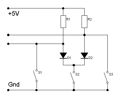

I am trying to save on inputs by multiplexing three switches to use two inputs..
I get the idea in theory, which is that 2 inputs can have 4 states 00 01 10 and 11.
but I cant figure out how to wire up my switches. Simply wiring one switch to both inputs to make a 11 doesnt work for obvious reasons...
The switches are simple push to make buttons using weak pullup resistors (external, not the ones built in to the PIC).
I have googled for switch multiplexing, but cant find anything useful.
If anyone can offer any help on how to wire this up, or point me in the right direction I would be grateful.
John

You need blocking diodes to each switch, one for the '01' switch, one for the '10' switch, and two for the '11' switch. In fact, you could do it with only the two for the '11' switch.
It should be obvious how to connect them?.

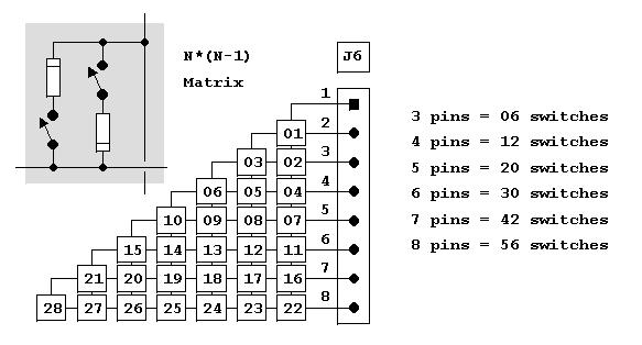

typically, multiplexing only decreases pin count once you get above 5 inputs. you use a number of IO that is the square root of the number of switches (rounded up of course)
with 3 switches, you have a 3x1 matrix, ie- not even really multiplexed. at 4 switches, you would go with a 2x2, which is 4 IO. at 5 switches, you use a 3x2, and use 5 IO. at 6 switches, you still use a 3x2, and so you only need 5 inputs. and from then on you keep going up and up and when you get to 16 or 25 inputs, you are saving tons of I/O.
*edit* i've never looked at these diode methods, perhaps it's possible with those somehow.
Actually, using the N*(N-1) multiplexing scheme, you can realize pin savings when you get to 3 pins ---> 3*(3-1) = 6 switches (or 6 LEDs, or 3 switches and 3 LEDs)...
Regards, Mike

OK, here's a diagram of what I meant, obviously it has no way of discriminating between multiple key presses, but it allows three switches to use only two pins.
a little disadvantage of the 3buttons/2diodes->2pins solution:
if the 2 single buttons are pressed simultaneously You'll get the same result as if only the 'dioded' button is pressed.
If You got a free A/D-pin You can use it to read all 3 buttons (or more) seperately with only one pin.

However, it's more complicated than the diode gate way I suggested earlier, which looks to be as much as you need?. You mentioned that two of the buttons are UP and DOWN, use the outside two for those - this means that pressing the outside two together will have the same effect as pressing the middle one. Pressing the middle one with either of the others gives the same response as well.
I'm presuming the third button is 'select', 'OK', or something similar?, so I don't see any problem with that being the centre button.
