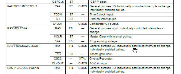

Hey there,
I'm now learning how to use the ports as the inputs, and I bumped into a small problem there, the switch is not working. The switch, when I hold it, it's permenantly on, and when I release it, it's off. Just a simple one.
Here's the code: (I took some of them from the PICKit II tutorials since I have the training board)

The push-button switch is RA3. I have accessed the TRISC, put them all to ones, but it's still not working the way it should. :confused:
Look at the 690 datasheet for RA3... check for pullup etc.:)
