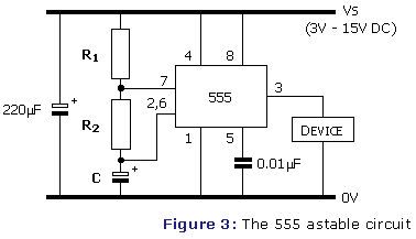

ok, basic 555 circuit as shown below.
couple of capacitors, couple of resistors, and one IC. Max cost about £1. Transistor to power relay - depending on the type of relay, probably no more than £1.
Total cost, therfore - about £2.
1 Second cycles should be fine - do they need to be extremely accurate?
components for 1 second cycles - I assume that means that it flashes once a second, not on for a second,and then off for a second?
Anyway, for a frequency of 1Hz, use this formula:
Frequency = 1.44/((R1+R2+R2)*C)

my brain hurt trying to solve that formula, so I used the calculator at (just for future reference): **broken link removed**
it reckons something like R1=2.2K, R2=68K, C=10uF will give an approx 1Hz output. Duty cycle is roughly 50% - i.e. the light would be on for about the same time as it is off.
You may want to play with the values until it suits you.

Well, I got the 555 to work. For R1 I used 1K, for R2 I used 1000k. I used .1uf for C. It gave me a 50% duty and just the speed I need. Thanks alot guys for your help!
