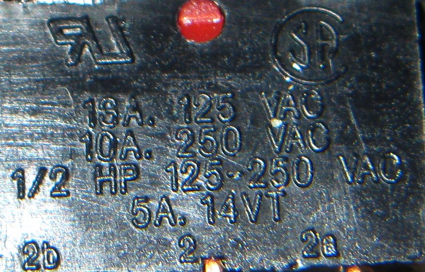

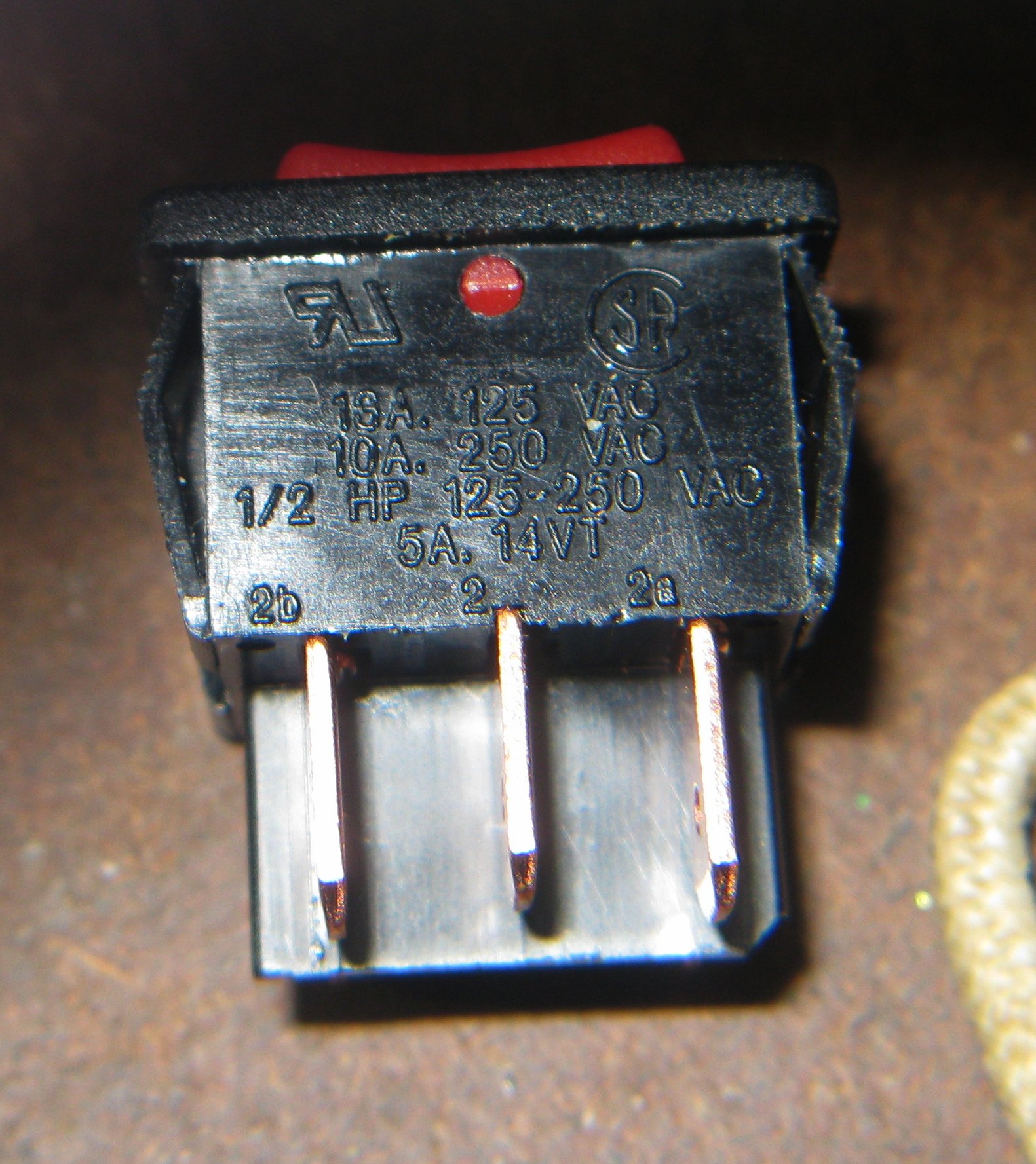

Hello there,
Recently i was given the following spec's for a particular switch (close ups shown in macro photo attachments):
13 amps 125vac
10 amps 250vac
1/2 HP, 125vac to 250vac
5 amps 14 VT
Note the above "14 VT".
Clearly the other ratings are for 125vac and 250vac, but i cant remember what that "VT" stands for as it's been so long since i've encountered this kind of rating. I think we even talked about this once in this forum or another forum but dont remember the conclusions we came up with.
So anyone remember what the VT stands for?
If not, feel free to throw out some ideas, guesses, etc.

Hello ronv,
Did you look at the switch itself?
Here's the exact writing on the switch except for the HP rating:
13 A. 125 VAC
10 A. 250 VAC
5 A. 14 VT
So i assume that the last line there is all one specification. So in light of your previous post, what do you think they mean by:
"5 A. 14 VT"
That means the switch is rated for 5 Ampere at 14V tungsten service. Hence VT is sometimes written V(T). The V has its usual meaning. The T or (T) is added to denote type of service.
John

I totally forgot about that rating. I know that temperature SCR units could be purchased for tungsten loads. The cold resistance is like 10 X lower than the hot resistance of the lamp.
John
Ok that makes sense, thanks. Thanks ronv also :)

means the switch will operate just fine with a bulb that has a tungsten filament that draws 5 amps or less and at a voltage 14 volts or less, and that's all we have to know. By trying to specify whether or not that 5 amps is the "break current" or the "normal operating current" is futile because they are both the same, which would be 5 amps (max). So specifying either should be ok, knowing that the other is the same. I took it to mean the "normal operating current" but Eric's interpretation as the "break current" is equally valid.
We dont really have to think about the surge current, knowing it will be around 10 times higher for a tungsten bulb but will last only a short time.
So to put this into an application, with a switch rated 5 amps 14 VT or as pointed out by jpanhalt 5 A 14 V(T), that means we can go out and buy a 14 volt tungsten filament bulb that draws 5 amps nominally and expect reasonable life from the switch. That's as simple as it gets :)
