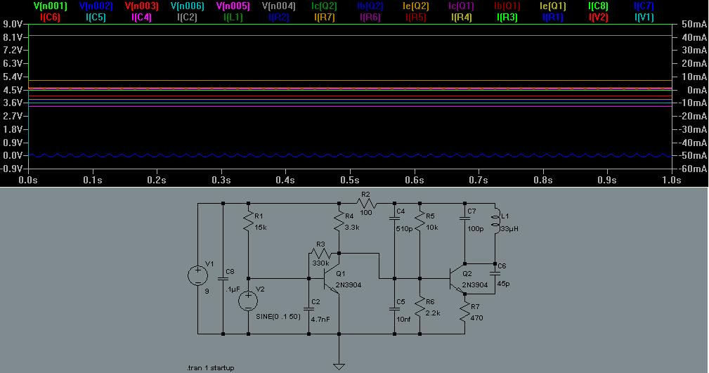

I know that I am probably doing something stupid, but I've built a transmitter circuit. The thing is, when I try and see the oscillations, all that I get is a straight line. I am testing in the right spot . . . in the middle of LC.
When I select skip initial operating point solution, I see a wave for just a second, and then it dissapears and all I see is a straight line. WHAT IS GOING ON!?!?!? :x
Also, what is a floating node??

A floating node is one that has infinite resistance to GND, such as the end of a dangling component, or the junction of two series capacitors. If you have a legitimate case like this, you can add a LARGE resistance to GND, like 1e12 (10^12) ohms.

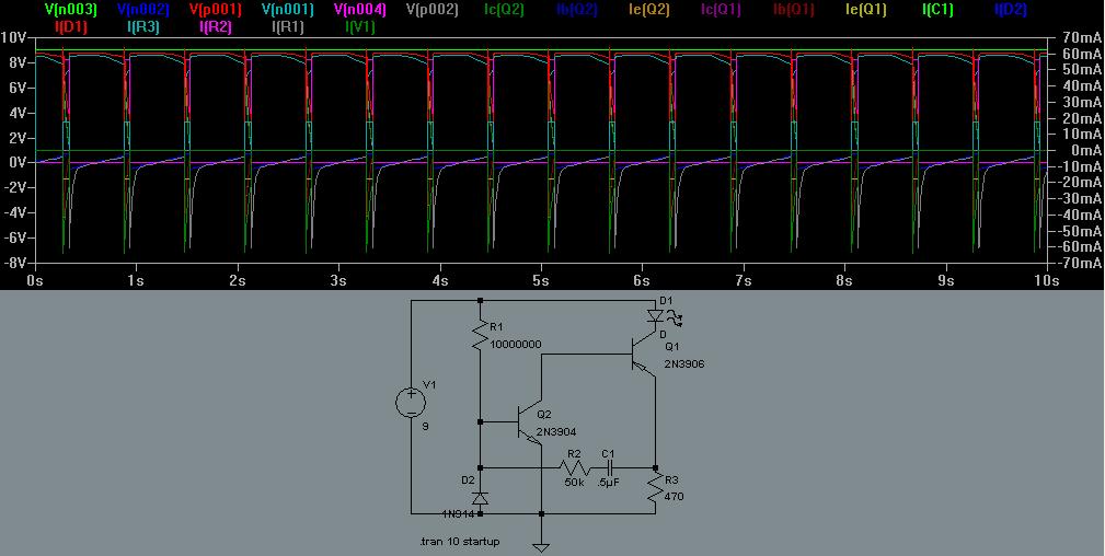

Here they are. If someone would be so kind as to supply me w/ an email address, I could send the .asc to someone. panic mode, you said to post the asc . . . that's a program, not a picture, so how could I post it?? I made this LED flasher on the CAD program, and it worked great. Thats the only thing that has worked though. what am i doing wrong?

asc is just a short text file, not as compact as SPICE Netlist but close enough.
btw, I see your schematic is missing capacitors between mic and Q1,
and between Q1 and Q2. Also 1ms is not quite long time. Some
oscillators are slow (like this one) so try changing transition time to 3ms for example. Btw here is ASC file I created:

That was one of the STUPIDEST things that I have ever done!!!!!!!! I thought that putting in 1 meant putting in 1 second, not millisecond!!!
stupid stupid stupid stupid stupid stupid stupid stupid stupid
btw, thanx :D
