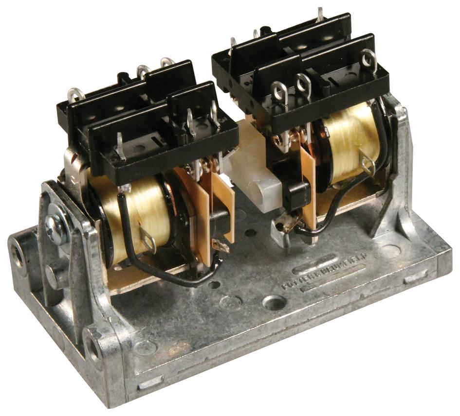

OR, a 2-relay mechanical-latching flipflop. Now the entire circuit is the relay assembly and two switches. Here is an old-style one from P & B that can handle large loads. There are many smaller ones these days.
