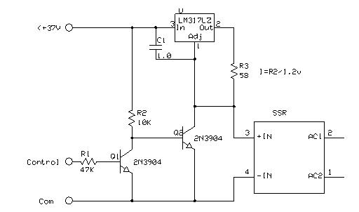

Dkngyen,
We had to do this for a laser diode for one of our senior student's Honors Projects. Constant-current source using a standard three-terminal voltage regulator with a switched shunt to chop the laser output. Attached is a schematic, scaled down to fit your current levels. High control turns the SSR ON, low turns it OFF. If you need the reverse, drop Q1, move R2 to between the base and emitter of Q2, and put R1 between your control input and the base of Q2. The component values are a "mind experiment" and not bench tested (we were using much higher currents), but they should be close enough to start.
Ken

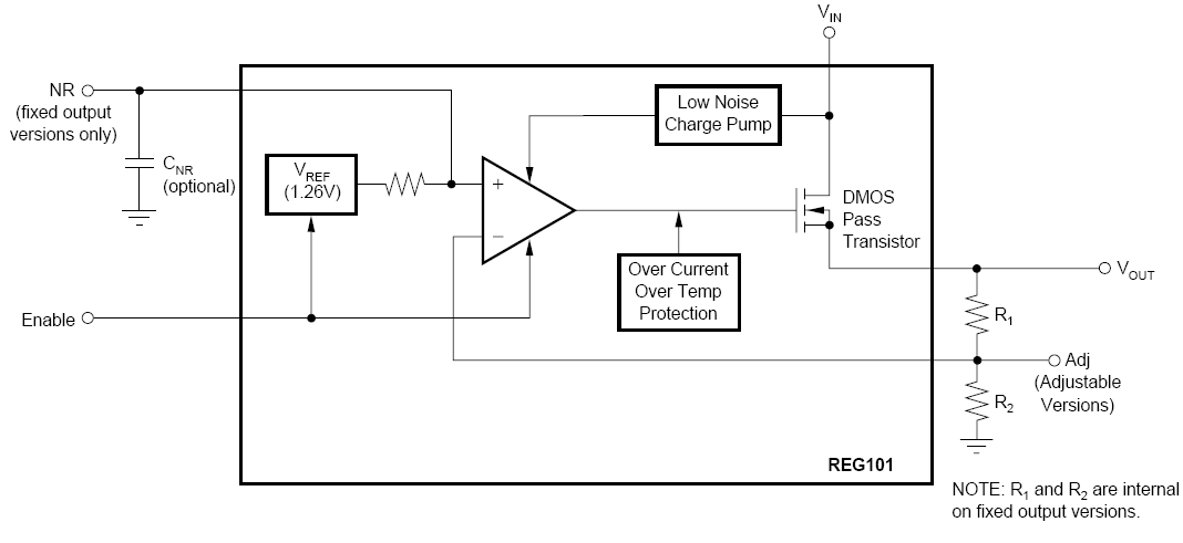

Oh, I kind of see what you did. You may remember me saying earlier how I prefer MOSFETs over BJTs especially for switching. THe only time I ever use BJTs is when for something like a zener regulator or something like that. So what happened when I shunted using a MOSFET is the current levels would change by quite a bit since the voltage drop across the MOSFET was much less than the LED. So the current and voltage levels jumped around quite a bit.
THe way your circuit works is you used another diode as the load? (The B-E diode of the BJT in this case) where it's voltage drop is just a little smaller than the LED so that it shuts off while the current levels stay at a similar point to the LED operating current?

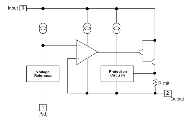

It's also neat to see how current regulators are different inside. WHen making a current source with these two regulators, the positions resistor and load are interchanged because the feedback loop of one feeds to the amp while the other feeds to the to the voltage reference.
EDIT: Nvm about the second paragraph. The LM317 works differently from the REG101A. The load in the current sourcing LM317 is not in the feedback loop like it is with the REG101A so when you shunt the LED current for the LM317 it doesn't there is no dynamic voltage/current change going on for the LM317 like there is with the REG101A.

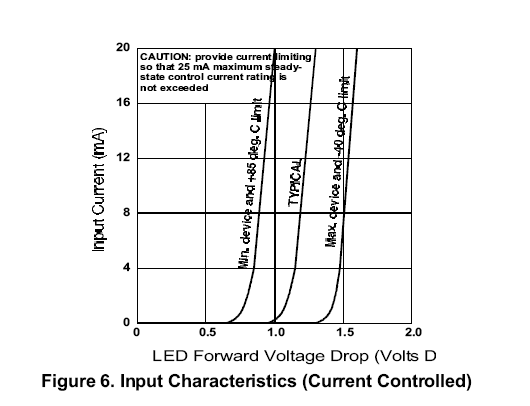

I don't think it's going to be a problem (see attached LED graph for forward voltage). I calculated 2V for the LM317 at worst case everything.
dknguyen said:
I don't think it's going to be a problem (see attached LED graph for forward voltage). I calculated a headroom of about 2.25V
Yeah, I looked it up too, after I posted.:( The LED only drops 1.3V. I still would not make a production run with that circuit, but it's probably OK for a one-off. It certainly is simple.:)
