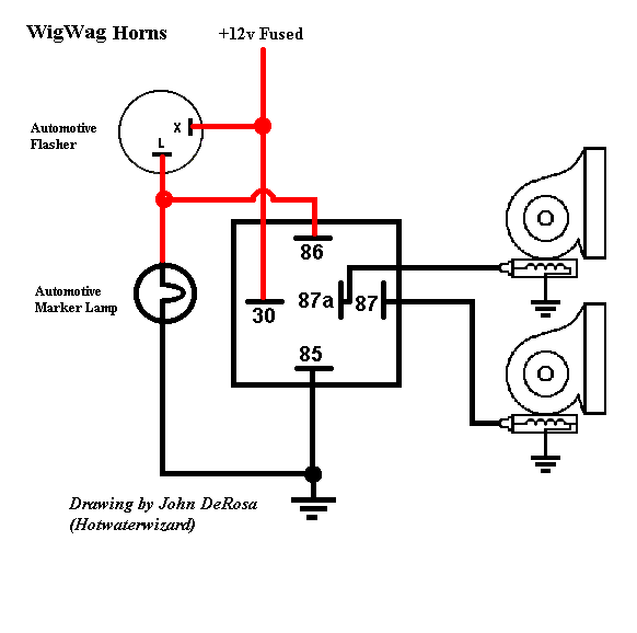

It sounds to me like he wants the high and low horns to sound alternately: high-low-high-low...
A single SPDT relay can do it. Power into the center terminal, high horn on the N/C terminal, low horn on the N/O terminal. Use a 555 astable circuit to toggle the relay on and off. Add a switch or button to turn the entire circuit (including horn) on and off. Done.

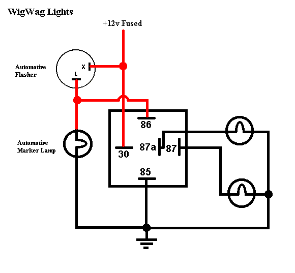

Why is this any different from the wig-wag headlight circuit?
Here is what I was talking about
