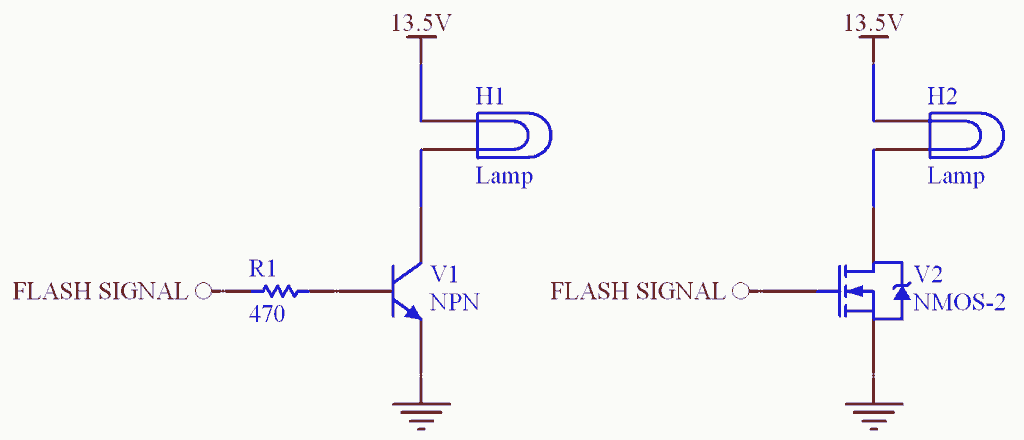

I am attempting to build a PIC version of a brake light flasher. I build an Analog version, which works but was rather cumbersome (and boring), so i would like to apply what I am learning on the PICs.
My question (from not knowing a ton of electronics) is how can I switch a 30 watt load? Voltage would normally be 13.5 or so, giving about 2.22 amps?
There are two 15 watt bulbs, in parallel, which would be flashed.
Additionally, would turning them on/off be better than PWM? They are incandescent, not LED, if that matters.
My thought is turning them off to flash them would provide protection against PIC circuit failure?
I think i can figure out the delay sequence based on Nigels tutorials, but if anyone has sample assembly code built around this, I am open to any options. Analog version had adjustment for amount of time to flash, and number of flashes.
To switch a larger load, you may wish to use a transistor - e.g. BJT or [MOS]FET. Attached is the schematic of how it could be done with either type.
Note that a FET will need to be capable of operating with the gate voltage provided by the microcontroller. Alternately, if using the BJT, the current gain must be such that the small base current supplied by the microcontroller can switch the required current; you may need to use a darlington transistor or similar.

Well I've only just started reading about this so I might be wrong, however..
The gate voltage on that datasheet looks to be between 2-4V, which your micro can supply. So that seems in order. It can handle many more amps than you are switching, so that should also be good.

Tightwad, mosfets can be tricky, because depending on the current you need and the Drain/Source voltage the Gate voltage required varys. Technically your 540 isn't a logic level FET, but it'll work fine for your purpose, if you needed the full 33 amps of current you'd probably have to provide a higher gate drive.
If I can read the datasheet correctly, that fet is not good.
With the threshold at the specified 2-4V, the drain current is specified to be 250uA.
Have a look at Fig 3. For VGS=5, ID=~27A; RON = ~1.85ohms. At your required 2.22A, this will drop ~4V and dissipate ~9W. It will waste power, get hot and possibly warrant heatsinking.
Keep looking through your stash of mosfets for either a logic level one, or one with a lower RON/RDSON.
dougy how are you calculating those values? All figure 3 shows is Drain current vs gate/source voltage with a drain voltage of 50 volts how are you calculating RON? Mind you the posters Drain voltage is 13.5 volts. If you say I'm wrong I don't mind, but I'd like to be able to figure out how to calculate RDSON for a given DS and Gate voltage from the datasheet. I usually realy on a simulator to figure this stuff out, but I don't have a model for the 540N
For VGS=5, ID=27, VDS=50. RON = VDS/ID = 50/27 = 1.85 ohms. You are correct though, I have missed a few obvious things... such as the fact the Fig 4. shows the normalised RDS, and that Fig. 1 shows the current well pinched at VDS=50, and that RDS is actually 44mR in the top table. I think Fig 1. shows the important information - for VGS=5V, at I=2A, VDS < 0.1V -- so again, my apologies, you are correct, the irf540n should be fine.
ID=27 amps? He's only passing 3amps, at 13 volts.
I know. I was just reading from one graph assuming RDS would be constant for a given VGS (which it's not) without bothering to look at the graphs right next to it. I've already admitted defeat.
I found the IRF model for the 540n. With a gate drive of 5 volts, and a 13.5 D/S voltage, with a 4.5 ohm resistor as a high side load I get 400mw's disipated in the package with 3 amps being passed. RDS on is relative to D/S voltage with a constant gate drive. You only run into problems with logic gate drive when you have a high drain/source voltage, or you're pulling a lot of amps relative to the mosfet constructions capabilities.
