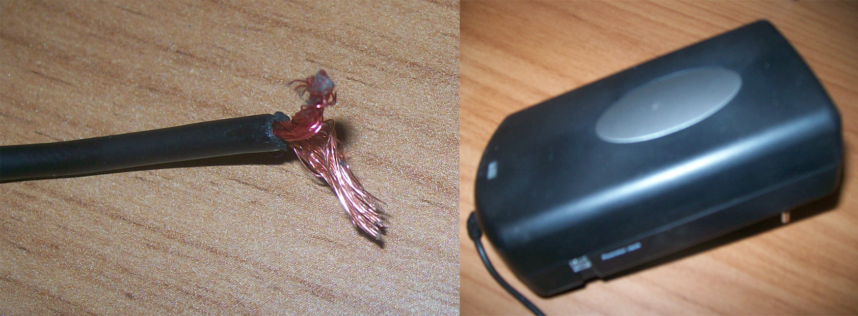

I bought a switching power supply (MODEL: MW7H380GTGS, PRI: 100V - 240 V ~60/50Hz 700 mA.
It has a hole at the side that you can insert some kind of resistance so you can regulate the voltage and the current.
I want to use it to supply a circuit on breadboard
As i do with other power supplies, i cut the wire at a point. I remove the plastic and then i wind the power supply's cables with small wires (the ones which use for connections on breadboard). But when i remove the plastic from this one, i saw that the positive's wire consists of lots of small red wires and the negative consists of gold ones. I try to wind them but nothing happens.
Someone told me that these wires have vernis and i have to remove it somehow and then try to connect the wires.
Any suggestions to fix it?(i am a novice so be gentle!! :))
P.S. If i cannot connect to the breadboard wires can you suggest a way to reconnect the wires of the supply?
Thank you!
Here is a photo of my supply. At the right, the power supply shows up.
At the left is the wire of the supply that i have cut off. I want there to connect the wires we use for connections on breadboard.

You mean veneer? That look like litz wire. That's an extremely nice power supply! What you're looking at is a bundle of magnet wire, meaning it has a thin enamel coating over the top of each wire, running all of these lines in parallel is better at high currents. To get rid of the enamel the best way I've found is to generally pass it through a small gas flame, you'll get a little smoke as the enamel burns off (I wouldn't recommend breathing it) You'll have to clean the smut that's left off afterward very well and solder the jumper wires onto it, twisting it will not produce a reliable connection. It seems a little strange to have this type of wire on a small supply, what is the voltage and current the output is rated for?
I'll agree Sceadwian here too about removing the enameling on the conductors. I tend to just burn through the stuff with the soldering iron, flowing on plenty of fresh clean solder (an it's rosin) to tin the end. It will smoke a bit and smell but yes, try not to breathe it!.
One final thing about using Switchmodes like this for breadboard. Make sure the power supply unit has plenty of real issolation from Mains so that if any kind of failure happened as you worked with the circuit design on your breadboard there's no chance you can ever become bodily connected to Mains voltage potential.
That power supply likley can suplpy a decent ammount of current, there's no other reason I can think for them to use Litz Wire, so you'll almost certainly want to design an overcurrent protection, at the VERY least you'll want a 1 or 2 amp fast blow fuse. Most breadboards are only good for about 1 amp because of the contact design.

That's not litz wire peter. That's just highly stranded cable, what he has each individual strand is insulated.

You've re-iterated the point that I was contesting =) Litz wire is not made by it being a fine grain wire structure, it's made by the fact that each wire is insulated from the others. If it's not insulated, if it's just air tight fine wire, it's not litz.
