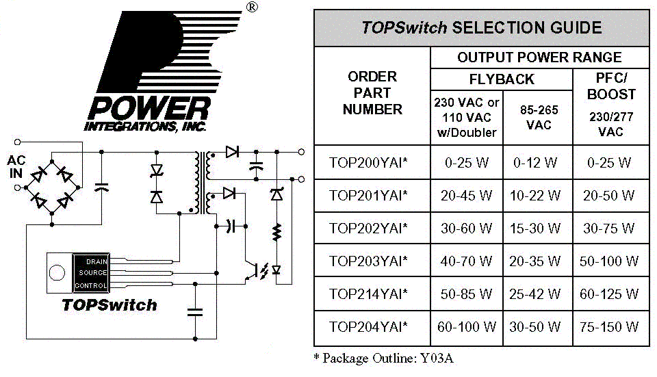

Does anyone have a schematic for a small, simple, switching PSU - input 240Vac, output anything between 5-25Vdc, about 5W?
A discrete component solution would be nice, but not necessary.
What do You think about this?
