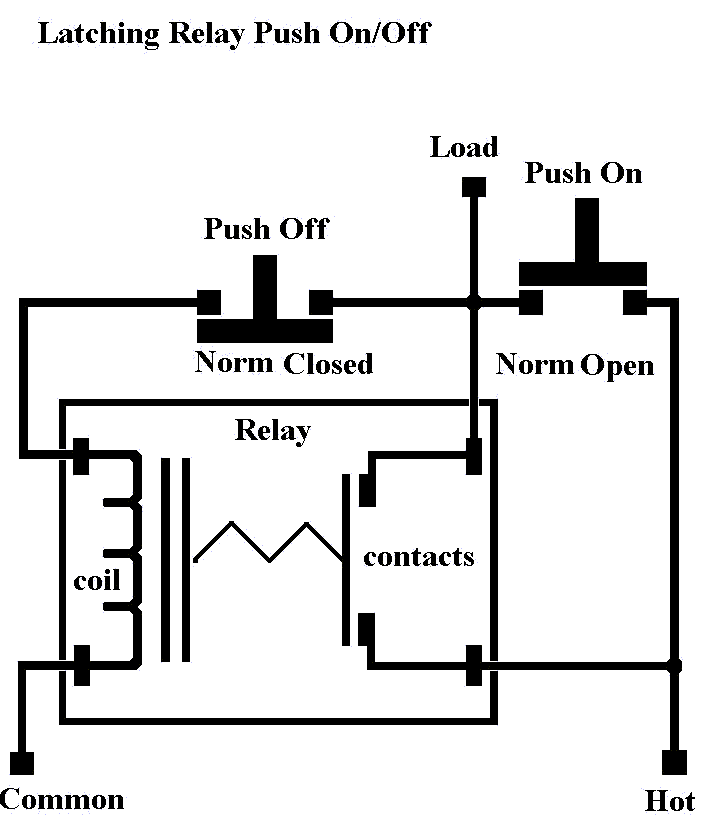

How about a simple latching Relay?
that would mean use of two buttons.
original post requires single button solution...

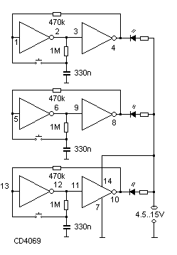

I mean, for beginner not simpler as this:

The circuit above this post.. im having trouble understanding it.
Its runnning on an IC... But where are the latching outputs... or the changing outputs....
Thank you again!

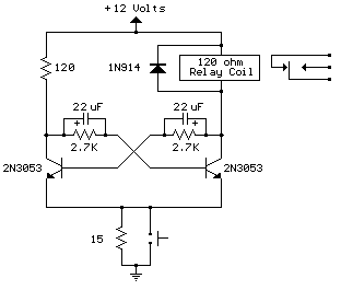

this is what You are looking for:
hth
regards
joachim

Sweet! that one looks like the one!
This one looks really simple.. for ppl like me to make.. Just a question though.. what the 15 at the bottom (next 2 the resistor) 15 ohm or 15k?
and also are the 22uF caps. 16V ? or something else?
