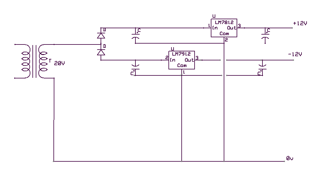

You could do it this way, not very elegant, but its +/-12Vdc
That will certainly work but if significantly more current is drawn from one rail than the other then the transformer's core might saturate and overheat.
Yeah and it's half-wave, but it IS a solution.
It depends on what it's being used to power, if it's a general purpose bench-top PSU then I wouldn't recommend it but if it's being used to power an audio amplifier it's ideal as the current draw is roughly symmetrical.
