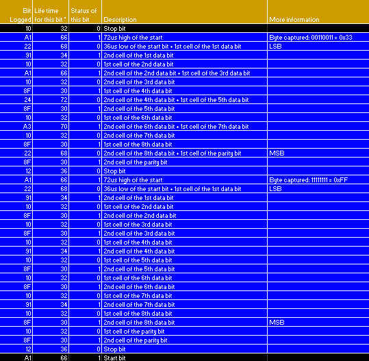

This was a month ago:
Bit Logged;Life time for this bit *;Status of this bit

This is the log now:

This how the bit logger works, I am posting this because this software was made by a friend of mine and maybe people don't know how it works.
