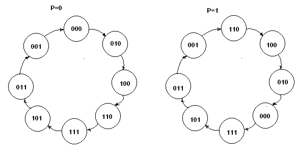

Hello Fellows, I need your help. I designed this counter and already built it in muy bread board. But it doesn't work properly.
The sequence is as follows:
P=0-----> 0, 2, 4, 6, 7, 5, 3, 1
P=1-----> 6, 4, 2, 0, 7, 5, 3, 1
Here are the state diagrams and the tables. I didn´t post the maps because I Think that the mistake maybe here... Please tell me if you fine one.

Mistake already checked.
