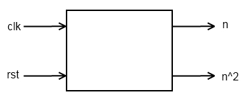

I'm trying to sketch a block diagram of the following system using discrete components (as counters, etc).
the output of this system would be
n: 1, 2, 3, 4, 5, 6 ....
n^2: 1, 4, 9, 16, 25, 36, ....
for getting n, you just use a counter.
but, how do you get n^2?
Thank you very much.

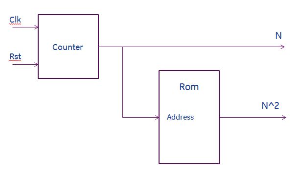

Easiest HW solution would be a lookup table implemented in read only memory.
the memory would be initialized to the address^2
Hi jrz,
wow, that's a great solution.
I was hoping for an answer which doesn't use a look-up table.
As the shift-left suggestion I mentioned, but I don't know how to implement it in HW.

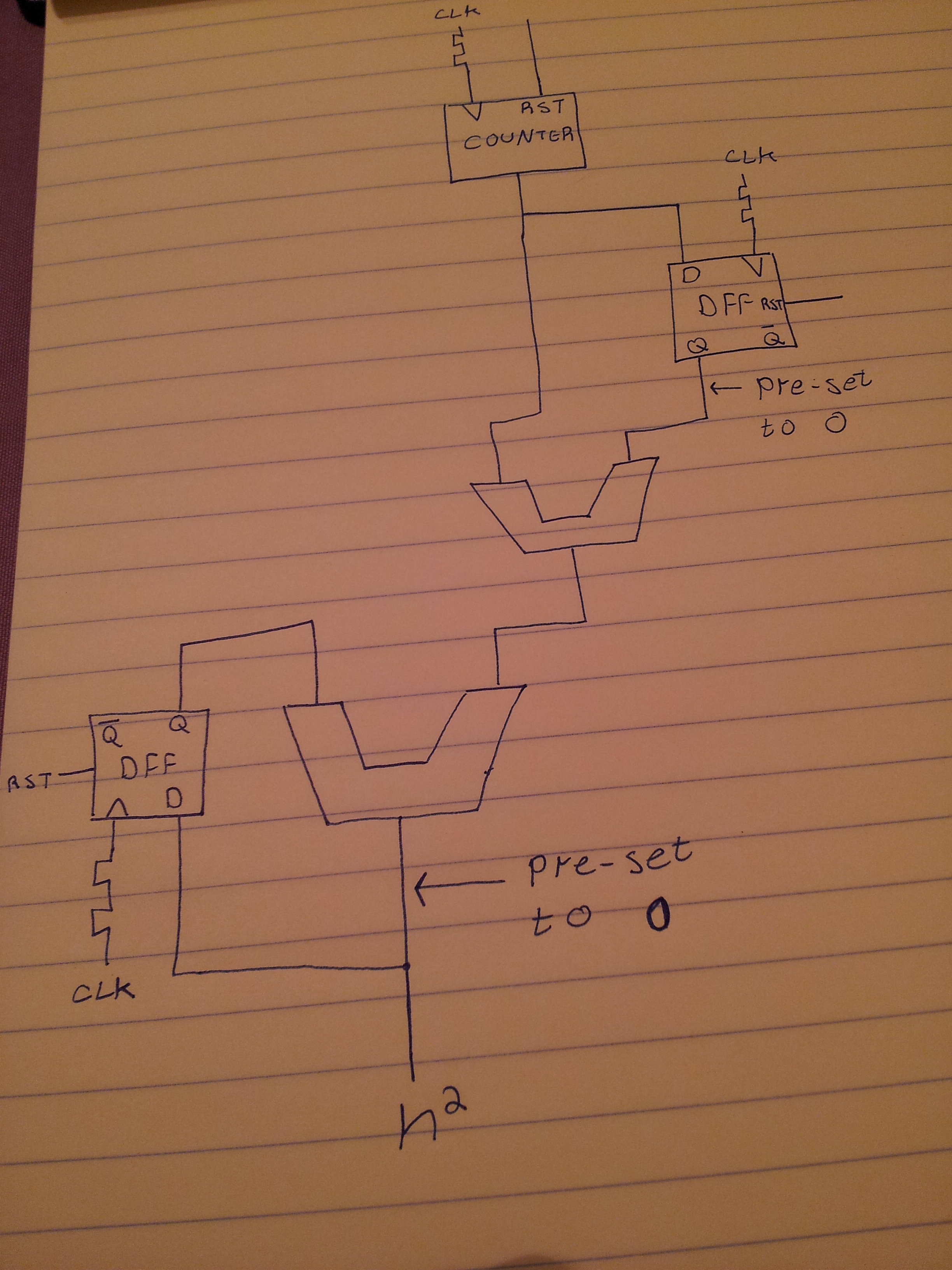

I would notice that n^2 = (n-1)^2 + (n-1) + n (Here ^2 stands for square)
Then at every change you just get (n-1)^2, which you already have on the second output, and add (n-1), which you already have on the first output, then you advance the first counter, so that it has n now on the first output, and, once it's done, you add this n to the second counter, so that now it holds (n-1)^2 + (n-1) + n = n^2.

North Guy,
I tried implementing your solution in HW.
Would you do it like that?

wow mike, thank you very much for this professional solution!
I got one thing i didn't understand - how do you get n^2 by shifting right the accumulator result?
It doesn't matter if you shift left or right, as long as you do it the exact number of times as you have bits in the register. Every time you shift, you are weighting the added values by the multiplier bit position. When you do math long hand, you're actually shifting right, you work from right to left, you are moving your 'pointer' left, so the data you are working with is actually shifting right...
So you start with the LSB, if a '1', you add that value in, then you shift the result right, and the multiplier... if the new LSB bit is a '1', and you add in your value again, that value adds twice the value to the result as the previously added amount, because the result has been shifted right... and the bit in the multiplier has a weight of twice the previous LSB bit... so like in long hand math, every time you shift your pointer left, the intermediate result shifts left also, giving a weight of 10x to that value, but if you look at your old data in relation to the new data, it has shifted right! Since we're not shifting our multiplicand, we have to shift our result the other direction.
When you do left shifts, you start with the MSB, as that bit has the most weight, and if you're shifting left, then what you're adding in has less weight in the result than the previously added...
