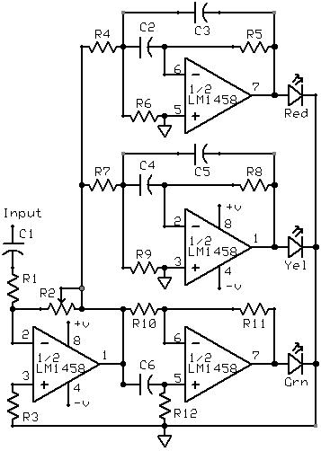

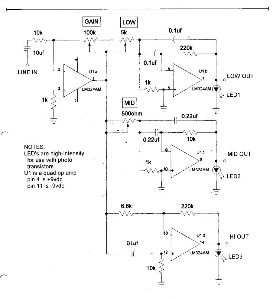

I've got this idea and I'm trying to determine if its possible and the best method to do it...
Basically what I want to do is feed an audio signal into my circuit which is low passed at ~150Hz by my subwoofer amp. The circuit will then process the audio and flash an LED (or possibly a strobe light) with a freq. slightly slower than the audio (differing by 1-2Hz). If it works properly, it should look like the subs are just slowly moving in and out (at the 1-2hz difference).
I think I might need to add another LPF in there to cut the freq down to 80Hz or lower since there isnt alot of excursion at the higher freqencies.
It might be easier to do this with a pic...if its even possible.
It may be posible to to analog.Low pass it and add a cap to make a bit of a deay then feed in the LED.
It should also flash to the beat
Here is what I have.

Nice idea, probably not as simple as it first sounds. I'm thinking the only way that could work is a frequency-to-voltage IC connected to a voltage-to-frequency IC and calibrated as you want. A 555 could do the voltage to frequency part using pin 5, albeit rather poorly (with the PWM changing with frequency, and its non-linear response).
A better if more expensive way could involve using chips such as the LM2917 frequency-to-voltage IC and the LM331 voltage-to-frequency.

He doesn't want an audio sound level light bar. He doesn't want a color organ display.
He wants to shine a strobe-light LED on a subwoofer's cone at a slightly different frequency than it is playing, so you can see it slowly moving in and out.
