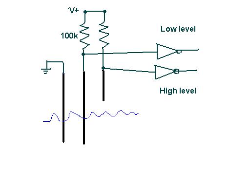

Hi people, I'm relatively new in industry, so i need some help. I'm designing a control system for a tank. The kind of control is "latch - unlatch", so I need a MAX and a min value of hight. The problem is the tank is underground and it is not accesible, so I thought about 2 proximity sensors IP68 (waterproof) but i'm not sure about this, and the other alternative is to use a ultrasonic sensor and a comparator (PIC16F877).

well it is a simple tank control, it contents commercial water and there is no turbulence. After investigating a littele more about sensors, I've found 3 alternatives:
-01 Ultrasonic Transmitter with 2 switching points
-02 Proximity Sensors (capacitive) with relay output and IP68.
-02 switching floaters.
The problem is that we have now installed a system consisting of 02 switching floarters, but the bad thing is that we have to do maintenance work every 2 months, and that means to cut the water supply in different areas of the complex. The principal thing on this is that the sensor must require minimum maintenance, once a year as maximum.

Clean water, use 3 stainless steel rods and pass a vey low current though the water to determine the level. This will never require maintenance.

Normal water conducts electricity - distilled water doesn't (or at least not very much). By having three stainless steel rods of different lengths in the tank, one down towards the bottom (A) (always in the water), one on the minimum mark (B), and one on the maximum mark (C). By measuring the resistance between A and the other two you can determine maximum and minimum settings.
So if you test A-B, and it doesn't read, you know the tank is below minimum, if it does read you know it's above minimum.
If you test A-C, and it doesn't read you know it's below maximum, if it does read the maximum level has been reached.
Stainless steel rods are adviseable as they don't corrode (avoiding maintenance), and low currents to avoid electrolysis. Although, to be honest, you wouldn't be pushing high currents through water anyway. It's probably a good idea to measure using an AC, rather than DC, voltage - although this possibly wouldn't be needed with stainless steel.
Try using your multimeter to measure the resistance in the water, see what it reads - depending on it's purity, and the distance between the probes, probably 100k's or 1M's.

The most reliable arrangement that i have met for this job where an
underground tank is involved, is the simple bubbler pressure sensor.
With this type of unit all the electrics and sensing gear is above
ground, and can be easily accessible if necessary.
The piece that goes into the water is just a length of tubing with an
open end. Probably tied to a stone to ensure it stays at the bottom.
Tubing probably plastic so that it wont corrode. Weight probably a
stone or a brick so that it wont corrode. Tied with maybe itself or
plastic string so that it wont corrode.
This is the most reliable and maintainence free arrangement i have
ever seen on this type of job. Just keep the air flow pretty low,

Nigel sums it up nicely.
I have used this method for pump controllers to pump in and out mostly for building sump pits and booster pumps for domestic water tanks.
The only draw back with this method is that a some flotsam like a plastic bag or dead pigeon could get caught up in the probes causing it to miss read.
With float switches they have to remain water tight along with the cables also you have to make sure they do not get tangled or caught on something. You dont have this problem with these probes, no moving parts and nothing to be kept dry.
Here is a very rough circuit to give you the idea. With the ones I have installed I put diodes and caps to protect the inputs in case some idiot goes wild with an arc wielder inside the tank.
