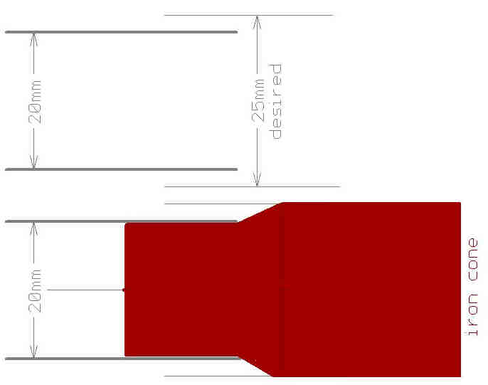

Hi dknguyen,
going from a wider diameter to a smaller one will be a problem.
It'll mean to shrink the material, which is possible, but hard to achieve.
The other way round it (widening) is easier to do and you can even do it yourself.
Use a 20mm (bore) aluminum pipe and drive an iron cone with the desired diameter into it. Use a shallow angle for easy shaping and make one end fitting snug into the aluminum pipe. When the desired length is achieved heat the aluminum slightly for easy pull-out of the iron cone.
Plumbers use that method to make "trumpets" at one end of a copper pipe for easy and tight connection.
Shrinking the pipe from 25 to 20mm can be done using a lathe and pressing the aluminum using a roller and a calibrated 20mm iron rod in the support.
Hans

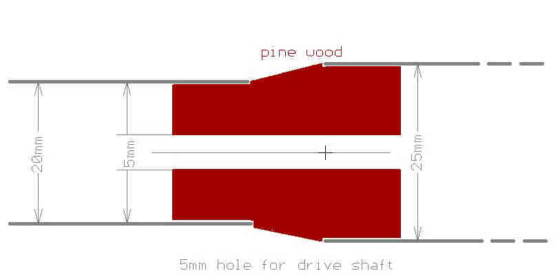

Hi dknguyen,
I imagined it was for a helicopter model. You might want to try something different and easier, not less elegant.
This is how i'd do it without lots of tools and machinery: Get two different dia aluminum pipes (20 and 25mm) which you cut to the desired length. Use a piece of pinewood shaped as cone to connect both pieces and use two component glue (Epoxy).
If the drive shaft for the tail rotor has to pass through drill a hole leaving enough space for it.
Supposedly you're going to paint the tail boom and nobody will see the piece of wood between the two sections if you do the job accurately what I assume. :)
If necessary smoothen the joints using putty. :D
Depending on the thickness of the aluminum pipes I'd consider glueing stabilizing ribs into it (a lot of work, I know) for maximum rigidity.
Please consider the length of the drive shaft. If it is unbalanced (not 100% straight) it will rip off the tail boom in no time. Plan for intermediate (maintenance free, sealed on both sides) ball bearings, using one at each end and one in the middle of the boom.
The bearings don't have to be pressed into the aluminum pipe. Rather press them onto the shaft and have them fit snug into the pipes.
When finished, don't forget to post a photo of your helicopter.
Regards
Hans

Boncuk You think that wood adapter is gonna hold up? Heli's are pretty nasty on the vibration side. You could just set the two pipes up on a jig so they're straight butted up against one another and use epoxy and carbon fiber tape, not gonna get much stronger than that.
THis is a belt drive so it's gonna need more room than for a shaft drive so there's no room for anything inside the tube. But anyways, 690mm x 20mm seems to work so that's what I'm gonna use. Narrow enough and long enough. I suppose I don't need a 755mm long tailboom. It's just nice to have extra tail authority and to have more clearance between main and tail rotors. But you do lose some efficiency since the tailrotor doesn't make use of the main rotor's blade tip vortex.
BUt I would have though that wood would help with vibration. It lacks tensile strength of aluminum or metal though.
Taking this route would allow me to not have to frankenstein the tailboom with the rest of the airframe. I would just have to just rob parts from slightly different versions of the same helicopter from the same company. But I'm probably just going to wait until the company does it themselves. They seem to be working on the exact same thing: Piecing the "smaller" helicopter airframe with the longer tailboom of the "larger" helicopter, but not the extra long tailboom of the larger helicopter which has the larger diameter. The airframe is actually the same airframe. It just comes with a slightly smaller main rotor assembly and a smaller canopy (so the canopy is going to look a bit undersized relative to the tailboom, but who cares...it's lighter).
The result is a helicopter that can run 550-600mm blades, whereas the smaller heli could run 500-550mm blades while the larger heli could run 600-690mm blades (which meant extra weight to accomodate the larger blades that would have gone unused for the most part, but for me the issue was the larger tailboom diameter to support the extra tailboom length was incompatible with my desired tail rotor assembly).
Vibrations are caused in any aircraft. Engineers normally design airframes with some flexibility to compensate for vibrations.
You might have observed the wings of an airliner "oscillating" by 3 feet and more in turbulent air, e.g. when entering the jet stream or in a thunderstorm.
The wooden adapter is really strong enough to hold up, provided each part is made with the necessary precision (not to fill the gap between two parts with excessive epoxy).
