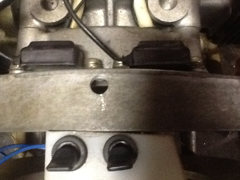

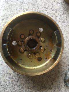

Dear Dr Pepper, I am posting 3 images ,should have done that in the first place. They show the complete system apart from the plugs.You can see the HT leads coming out behind the transistor boxes.they have a white covering.The motor revs to about 5700 rpm .If needed I don't think it would be hard to put on a small alternator.I think this system could work if set up correctly. It is possible to get a 3 wire COP coil eliminating the wire back to the ECM. As I said before when it comes to this sort of stuff I am technically challenged. I understand a dedicated pick up coil amplifier, but what is an Arduino & a Leonardo. I would be most greatefull if you could send me a schematic showing where & what to use.We have good stores out here to buy electronic bits Cheers Graham

You could use a 3 or 4 wire cop, the 4th wire on the 4 wire cop could just be left disconnected.
