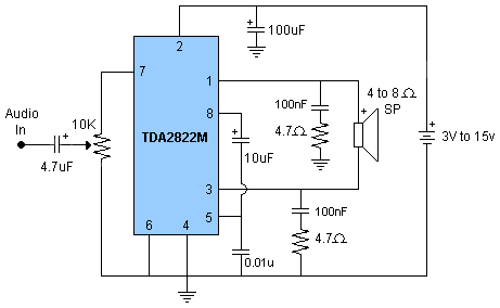

tda2822m over heating
You have not told us about:
schematic, supply voltage, how hot, what load (speakers), etc.

that's the circuit. 12 volts at 700 miliamps. 5 watt speaker 8ohms. 10k pot.
never did an electronics course. I am learning as I go along. thanks for all those who replied.
The datasheet for the little TDA2822M shows why yours gets too hot:
1) Bridged (BTL) with an 8 ohm speaker and a 6V supply its output is 1.35W with horrible clipping distortion or about 1.1W just before clipping.
2) A graph in the datasheet shows that then its heating is almost 1W.
3) The datasheet says that its maximum allowed chip temperature is 150 degrees C and its thermal resistance is 100 degrees C from its chip to the ambient temperature.
4) So with 1W of heating it is near its maximum allowed chip temperature if the ambient is near 50 degrees C.
Your supply voltage is 12V which is double the 6V and the current will also be doubled then since power equals voltage times current then the output power and the heating will both be almost 4 times more. About 3 times more heating than it is allowed to have.
