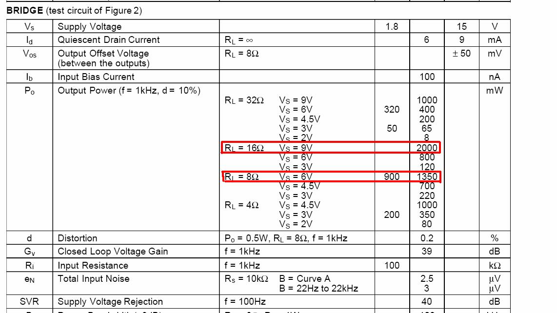

The datasheet for the TDA2822M shows a max supply of only 6V when it is bridged and has an 8 ohm load. Then its output is 1.35W into 8 ohms but an LM386 has an output of only 0.325W.
With an output of 1.35W into 8 ohms the chip temperature is about 95 degrees C which is very hot.
It will probably oscillate if made on a breadboard. It should be built using the pcb design shown in the datasheet.

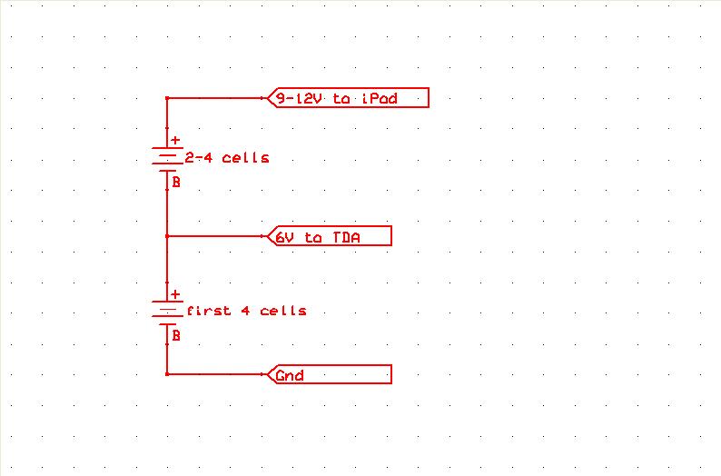

the TDA2822M is getting it's power from 4 AA cells and the rest of the cells are for the sole purpose of charging my iPod. Here:

If you charge cells in series with a different load on some of them you will destroy them in a hurry. Some will over charge while the rest won't charge enough.

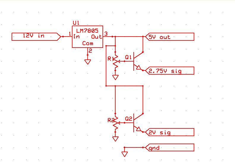

12V is too much for an iPod, the 12V will be regulated to 5V using this circuit:
so what you are saying is that if i try to charge the cells with the load attached, then i will end up destroying the load from over voltage? what if i had a voltage regulator before the regulator to prevent something like this from happening? that would still be hard to do though... what i need is a circuit that can sense when the charging has started and activates the regulator automatically somehow maybe some kind of transistorized sensor.

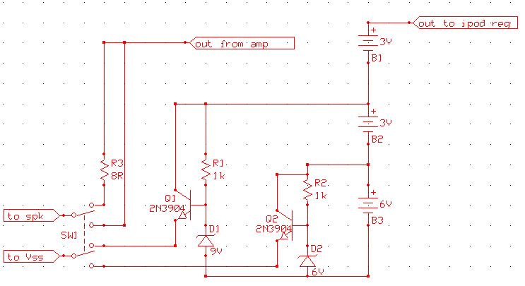

i think that i've figured out how to get this to work. what if i used a circuit like this, then it should be able to overcome the sharp increase in voltage when the MAX712 is activated... right?

What is the 8 ohm resistor for?
Aren'y you using the TDA2822M as a bridged amplifier that has two outputs to feed a signal to both ends of a speaker for much higher output power?
yes, the switch is a DPDT switch. on one pole the switch changes the supply voltage to 9V, while the other pole with the 8Ω resistor is to increase the load to 16Ω so that there can be an increase in output power. i'm calling it the "public/private" function.
Adding an 8 ohm resistor in series with the speaker reduces the power to the speaker and wastes a lot of battery power.
The TDA2822m IC will over-heat if it has a 9V supply, is bridged with an 8 ohm speaker and is playing loudly. Use 6V.
Where will you find a 16 ohm speaker? Use two 8 ohm speakers in series?
If you simply connect an 8 ohm resistor in series with an 8 ohm speaker then each get only 1W at a horrible 10% distortion or about only 0.8W each at clipping.
The TDA2822M can be bridged and feed two 8 ohm speakers in series, but the TDA2822M can also be in stereo and each channel feeds one of the two speakers for exactly the same total output power. Then it is simple to switch from mono speakers to stereo headphones.
