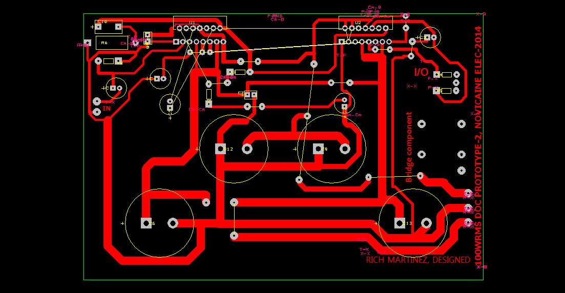

Hello guys I have been working on a portable stereo(mono but I use stereo for lack of a better word). I am testing rightnow with 4 6v lantern cells. I have the 6vs in a dual 12v configuration. I have the board etched...I have made about 3, one I didn't like the layout because I had too many jumpers, the next I blew the ICs for some unknown reason but obviously the layout was probably bad.
So now I have a circuit ready on heatsink and everything but I get DC on the test speaker when I apply the power. I am using my ipod straight to the input, it has a low 100mv peak RMS output as measured by my oscope. When I have the ipod at max volume and apply power I get the DC which pushes the speaker out and hear VERRRY faint vocals hardly noticeable. When I remove the power you can hear the music good and with decent output like it should be but this lasts a about a second obviously since the power is being removed. I have 4 large 10,000uF capacitors for my rail caps. 2 in parallel per supply side(+/-).
My theory is that the batts do not have enough ability to power the circuit. All I wanted was atleat 5watts or so so I can hear it and know it woks and move on from there. But this dosnt explain DC offset does it? Maybe the batts are horribly imbalanced they are very cheap rayovac batts.
I refuse to believe an IC or two is blown(shorted). These ICs are new. They do not get warm what so ever though. Check attachment for PCB layout. Btw I added a cap for dc decoupling even though the circuit from the datasheet seems to have one...I do so because ESP Elliot sound products says to add one.

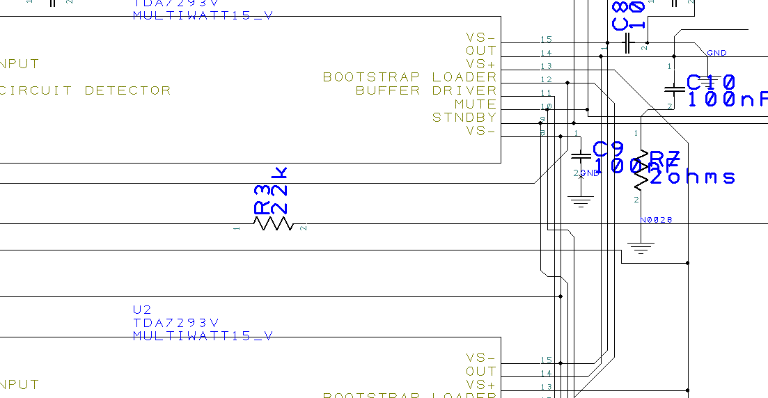

damn my crappy cad program only takes a snapshot instead of exporting the whole image...

Sorry, I didn't look at your pcb.
The only thing I can do is zoom out and capture the small image which is a little hard to make out I blew it up some so it dosnt look pretty. Its probably useless....Anyway I started this thread for some more simple theories..I don't think its the layout to be honest. I am trying a small 50 watt transformer rightnow and will see if it works.

Your schematic is .... shall I say it?
A mess of wires, parts and text all on top of each other.
With the power applied, please tell us how many volts and which polarity is the output offset voltage.
btw, I tied the mute/standby to +vcc because it didn't seem to do anything at all using the soft start method shown in the datasheet. I read that the ICs varied to where some simply may not power up with the mute/stby components shown in the datasheet....so I have them tied to +vcc as I was told that it would disable the feature and power it up.

Why do you have two ICs connected "modular" master and slave? Do you use the amplifier as a welder?

I wish your schematic will be readable. Maybe you can copy then modify the schematic from the datasheet instead.
OK, here is what I believe to be the uploaded schematic :)
Forgive any errors, but it was next to torture reading this schematic...
I myself see a lot of design errors in there.
In fact,I am suprised it worked at all.
Compare the above with the one in the datasheet.

Actually it didn't work at all. Sorry for the crazy schematic, I just draw quick schematics to translate to pcb layout. Have you guys not seen the data sheet? I can copy and paste the sch image no problem..
