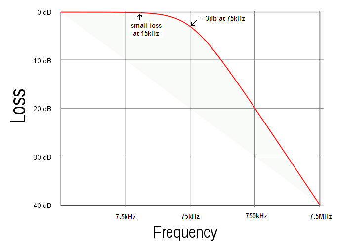

An amplifier like that doesn't really have a Gain Bandwidth Product. The GBWP is typically quoted for an op-amp so that the maximum frequency for a particular gain can be estimated. On the TDA7396 the gain is fixed at 20 times.
The roll-off frequency is 75 kHz, where the gain starts to fall, so you could estimate the GBWP at 20 x 75 kHz = 1.5 MHz. However, the roll-off might well be faster than the 3 dB/octave that is implied by having a GBWP. Also, you can't really change the feedback ratio, to sacrifice gain for frequency, so GBWP is fairly meaningless.

The minimum roll-off frequency is quoted as being 75 kHz, at -3 dB. That means that for a fixed input level, the output power will fall to half as the signal frequency increases to some frequency beyond 75 kHz. Although it doesn't say how consistent the output level is, I strongly suspect that the gain will be nearly flat until the gain rolls off at high frequency.
I would a expect to see a small reduction in gain starting at about 50 kHz, because the gain can be a lot less, about 14, by 75 kHz.
The output of a single-pole lowpass filter (in an opamp or in an audio amp) causes the output to drop 6dB (half the voltage) per octave, not 3dB per octave.
Its minimum rolloff is -3dB at 75kHz so its output will be reduced a little at 15kHz.
