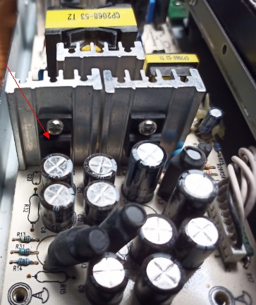

Few weeks ago I had a power cut for all the building and my satellite receiver got broken. The device display does not work, but the HDD it can be heard that it is spinning.The image on TV got the boot image frozen.

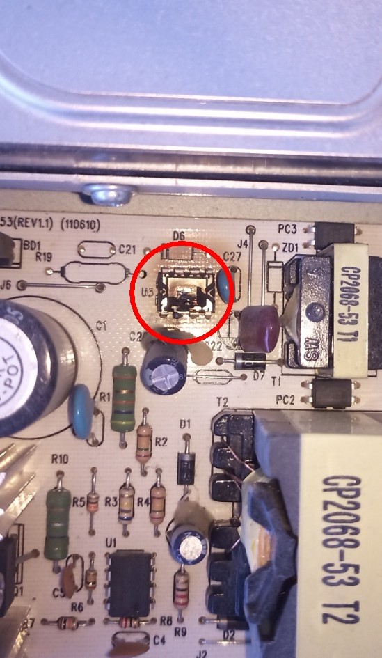

I opened the lid(cover) and I found the burned IC: SD4841P 67k65yw3j0fz which is visible burned.
I would like to know what equivalent can be installed since the SD4841P is a bit difficult to find it to local IC store vendors or it takes 2-3 weeks to get it from abroad.
For example if can be TOP221-227 , TNY264/266-268, TNY274-280P/G and if yes, from the given range which exactly and why.

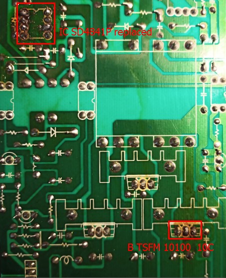

Good news, the IC SD4841P was replaced on the mother power supply board.
Bad news, when I unscrewed the power supply board, I saw other burned area, as you can see in the pic I send in this email.

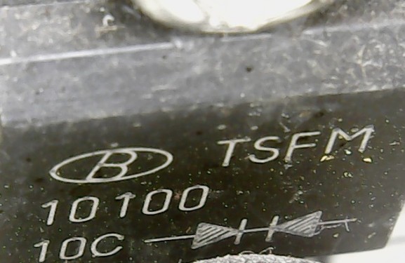

The worse scenario, I have searched in Google “B TSFM 10100 10C” and …nothing comparing with the other burned IC SD4841P that I have found suppliers on Ebay. So I do not know what component to search.
That area it belongs to the D3 , on the component is wrote: B TSFM 10100 10C as you can see in the pic attached.

So basically I do not know the component type to search it , I do not know the manufacturer, the "B" letter printed on the component is not helping a lot in this situation....
