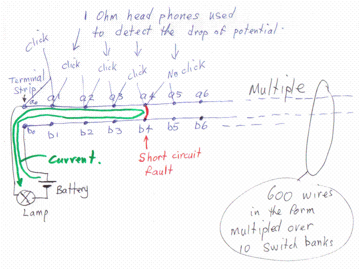

If you think there is a faulty component that is taking excessive current, you may be able to locate it using a modern version of a very old technique that was used in electromechanical telephone exchanges to locate a short circuit in a wiring multiple as illustrated in the attachment.
It was called the “Drop of Potential Test” (DoPT). The situation faced by a technician was this:- he has to locate a short between 2 tags in a wiring multiple where there are 600 wires multipled over 10 switch banks.
It was a formidable task to find a S/C in this nightmare. Although you can remove the switches and thus see the contacts, the soldered connections are on the other side and are invisible due to the wiring multiple. Disturbance to the wiring form (to find the fault visually) was to be avoided as it could cause extra faults. And it would be very time consuming.
So someone invented the DoPT. As you can see in the attachment, a current was created using the exchange battery and an incandescent lamp. The technician then used a pair of 1 Ohm earphones to detect the current.
Starting at the terminal strip, he would connect the earphones across a0 & a1, then a1 & a2, etc until no click was heard.
Thus the wiring form had to only be disturbed at the fault site.
So you could possibly do this on a PCB using a multimeter set to the millivolt range and measure the voltage between each point until the fault is located. It is more complicated than the exchange situation as the PCB track lengths will vary between the components and the track may change in width. Also, there will be a legitimate current in the track.
But if the fault current is large enough, then it should be possible.

Len, thanks for that....I think I will pull up links or components to try to see when the resistance goes up. This is only a theory I have developed to explain the problem....it may not be the cause. The only thing I can see wrong is the dropping of the -8.6, well raising really as it gets closer to 0v due to low er that normal resistance. I am a little time poor at the moment but I will try to find some time to look into it more...
