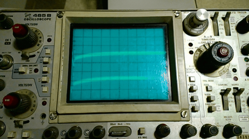

I just acquired my first Oscilloscope, a Tektronix 465B off of ebay, took a chance and got
it untested sold as is for $100 (shipped to my door step).
I powered it up, and did some initial testing, made sure both channels behaved OK when grounded (postioned on GND) and then tested against the calibration u-shaped link and saw
a nice square wave on both channels for the device's age and unknown untested it was all OK.
A couple of days later I powered it up and saw that CH1 was behaving erratic, it was Grounded and was showing a strange wave, i tested CH2, it exhibited the same symptoms.
I played around with different settings, different cases and all didn't make sense. Even the calibration wave form wasn't showing and my father helped as well as he has more extensive knowledge with oscilloscopes in general.
I have a GIF file that shows both channels grounded and shows a short animation of what i am seeing.
Hopefully someone here might help me get this working again, perhaps this can be an easy fix.

As both channels are affected the same way at the same time, my guess would be a power supply problem.
Maybe even an EHT problem. Can you hear it "ticking" as the EHT is sparking somewhere?

UPDATE:
Without getting into too much details of what happened, this is how the scope is now :( :
UPDATE 2:
After some thought, the LEDs for the active channels, grid illumination lights, Trigger light...etc are all dead!
this is looking more like an issue with a power supply perhaps? any pointers on how to proceed are appreciated.

I am troubleshooting the power supply circuit based on the service manual's schematics.
the Test Points:
110v measures 101v
+5 measures 2.6v
+55 measures 47v
+15 measures 0v
-8 measures 0.6v
I looked at component # U4411 which is an OP AMP, the input voltage to PIN-8 is 3.6 - 4v where it should be 26v or so.
I bought a new OP AMP IC, TL082 (same pin out and hopefully close enough spec) it didn't work, the voltage on pin-8 is still ~4v
Thanks for your help in all cases, i'll try to continue hitting this, in the meantime perhaps someone might have experience with this
specific model and/or problem.

Because the +55v is more or less OK, I suspect that U4411 is OK.
I suggest that you put back the original.
The voltage at pin 8 of U4411 is significant.
On the schematic which I have just downloaded, it shows the voltage to be 22V.
The 22v is derived from the +55v line by a zener diode VR4608.
I suggest that you measure the resistor R4412, should be 4.7k.
You will probably have to disconnect one end of R4412 to get the correct resistance reading.
If R4412 is OK I suggest that the zener VR4408 is faulty.

I just read your reply when I came here to update. As it turned out, following the +15V (which was showing 0) isolation procedure revealed that
the horizontal position knob was grounded by mistake when I was re-inserting the knobs) as soon as I made sure it is placed and tightened
without the internal connections hitting the chassis everything returned back to the starting case of this post.

Hi JimB
you were spot on with the power supply.
Capacitor C4419 (-8 UNREG) was replaced and all is good now.
Well relatively, both channels work ok, Channel 1 exhibits a thicker trace line and some fluctuation, but this is totally different and unrelated
to this, so i'll open up a new thread for that issue.
