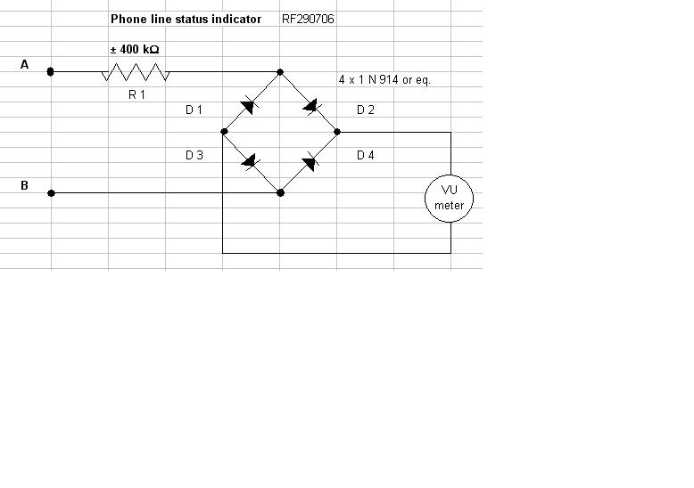

I use an old VU meter which will give a 3 status indication of the phoneline.
Across the phoneline A and B terminals is usually around 50 volts dc.
Connect via a 330 k:eek:hm: series resisitor a fullwave brige rectifier to drive the VU meter.
Set the R value so that the VU meter reads about 3/4 schale. This is the line voltage. ( R. values between 220 and 470 k:eek:hm: )
If phone is off hook, the voltage drops to about 1/3 rd of VU meter schale ( ± 10 Volts )
If ring tone is present the VU meter goes full schale.
I got this circuit permanently connected in my house on 3 different phones. Also the beauty is that it does not need a separate power source.
I think i listed the circuit on this forum before a while ago.
