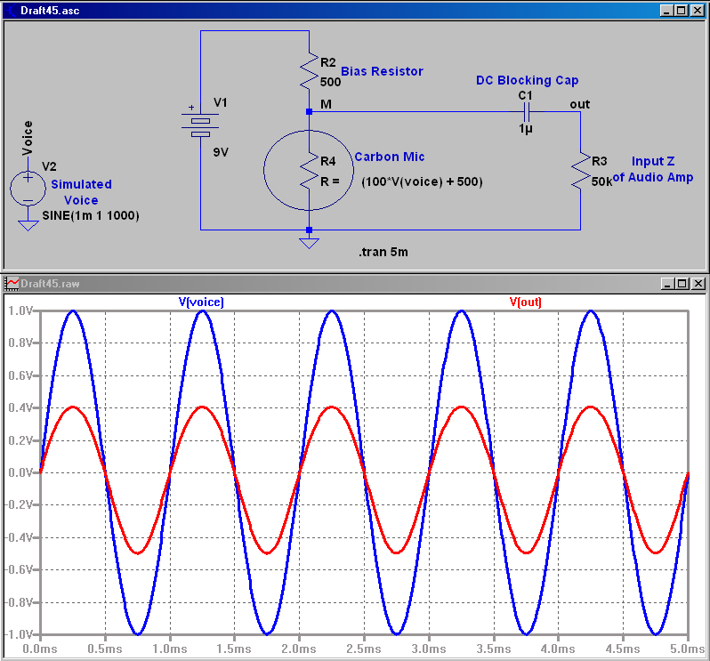

A carbon mic requires about 10mA of "bias" current flowing through it. Sound pressure waves rattle the carbon granules, varying the resistance, causing a varying voltage to appear across the mic element. To get 10mA, it will take much higher voltage than a single 1.5V battery.
Here is the idea. Simulated voice varies the resistance of the element. Because the bias resistor and the mic element form a voltage divider, and the mic part is changing with audio, there is a varying voltage developed at M. That is capacitively coupled to a load such as the input of an amplifer...
10mA will kill a 9V battery pretty quickly, so dont leave it connected. Another plus for an electret, which draws almost no bias current.

Mike, thanks for your help! I was looking at your schematic. R4 is the carbon mic? Or, do i need a resistor across the mic terminals?

R4 is my crude Spice model of the carbon mic, modeled as a 500Ω fixed part, and a 100Ω variable part. You do not need a resistor wired across it.

So i've moved on to the carbon mic. Mike, is that bias resistor (R2) really 500M? I don't think i've ever seen a resistor with a value that high. Do i need to use several resistors in a row to get there?

The 500 ohm resistor that powers the carbon mic from 9V can be 470 ohms, 510 ohms or 560 ohms.

The "M" on the diagram is probably the name of the signal. It's not associated with the resistor even though it is near.
