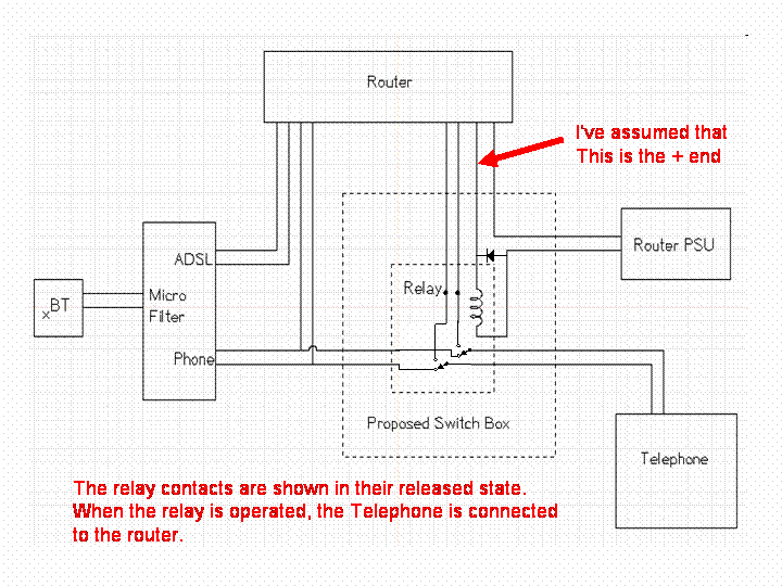

Here's a rough sketch of what I was intending to make. I hope it's clear enough - I've not quite got to grips with Xcircuit yet. The box marked "BT" is where the telephone line comes into the house.

Here is the circuit.
I have assumed that the positive side of the relay operating voltage comes from the router.
If not then you will have to reverse the diode.
The cathode of the diode must be connected to the + side.

You should put the relay in parallel with the router. The diode is a good idea.

Circuit diagram is wrong.. As said by Diver300, the relay must be in parallel with the router.
A diode is not necessary in this circuit as the current collapse in the coil is extremely gradual, taking place over the period of one to several seconds. The collapse of the magnetic field will not generate a noticeable voltage.
A diode would be used if there was a switch of any kind directly controlling the relay.
