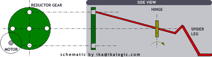

how ever i made you this schematic that may help, this is a simple mechanical system to transform rotaional motion into the motion of the legs of a spider, the schematic actually shows one leg only.
All you have to do is try to imagine it running, you will see that in case the GREEN gear is turning, the end of the RED leg will move also in a circle, which - if well sychronised with the other legs - will get your robot mooving..
I hope somebody understand this because lately on this forum, when i try to help someone, people tell me they didn't undersatand what i meant! :D

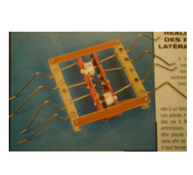

here is the same idea in a roboic magazine, this picture show a full working system with 8 legs. sorry if the pic quality is poor, i don't have a scanner.

The other variation of ikalogic's concept is to have the pivot for the leg be a slotted groove. The result is that rather than the leg extending outwards from the body, it remains in the same vertical plane. (More like a dog, cat, cow, deer, camel, or goat than like a spider or ant).
(Just think of the wheels of a steam locomotive and the bars attaching those wheels together).
