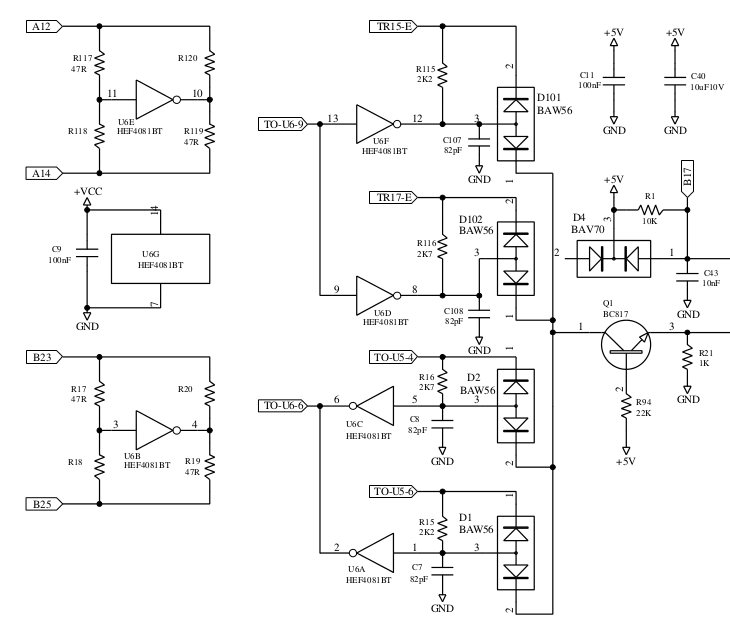

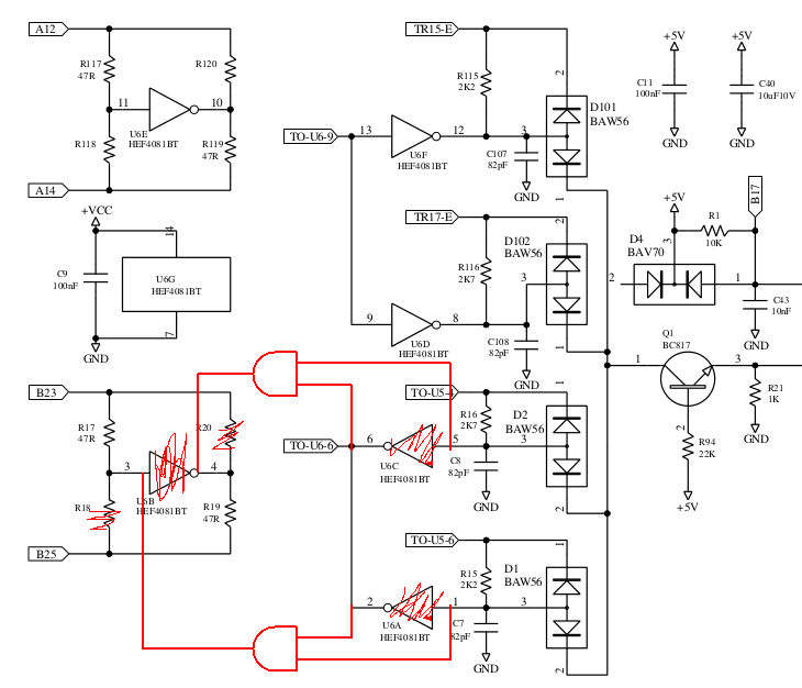

Here's something that had me perplexed today.
The attached image is a snippet of a schematic for a piece of equipment I was working on. I was interested in two signals entering at TO-U5-4 and TO-U5-4. From my general understanding of the circuit, I was pretty convinced these should be generating two sepperate outputs, and couldn't see why they would tie together at TO-U5-6. Furthermore, I knew that the outputs from the circuit as a whole appeared at B23 and B25, but couldn't for the life of me work out how any signal arrived at U6B. I'd searched all over the schematic for other references to B23 and B25... nothing.
Essentially, the schematic didn't correlate at all to the circuit I was expecting to see... I didn't understand how it could possibly work.
Now, the astute reader will have noticed that the inverters are marked HEF4081, and noted that the HEF4081 is a quad-AND, not a hex inverter. I'd looked up the part number and thought either I must of mistyped it or that it was something obscure that just happened to have "4081" in it.
So what's going on here?
It turns out that the pin numbers correspond to a 4081, but the symbols correspond to a 4096 hex inverter. That is, if you installed a 4096 on the PCB then you would have exactly the circuit shown - but the PCB has a 4081 on it, which makes it a different circuit. And the different circuit makesa lot more sense! I've made a rough modification to the schematic illustrating what you get.
Just to add to the fun, it also turns out that components with no marked values where not populated - the designer had hedged their bets, allowing the output from each gate to be router to either output.
Why did they do this?
It could be a last resort if you found your layout software didn't have the 4081 in its library... but I suspect this was to throw unsuspecting would-be coppiers off the scent. It certainly threw me for a while!

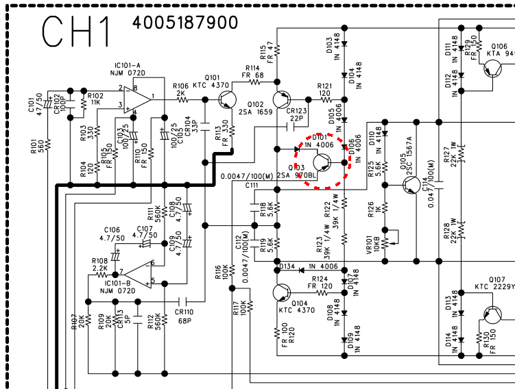

And another recent one...
I couldn't make head nor tail of how this transistor was supposed to do the thing it was supposed to do...
Until I realised they had drawn it upside-down!
