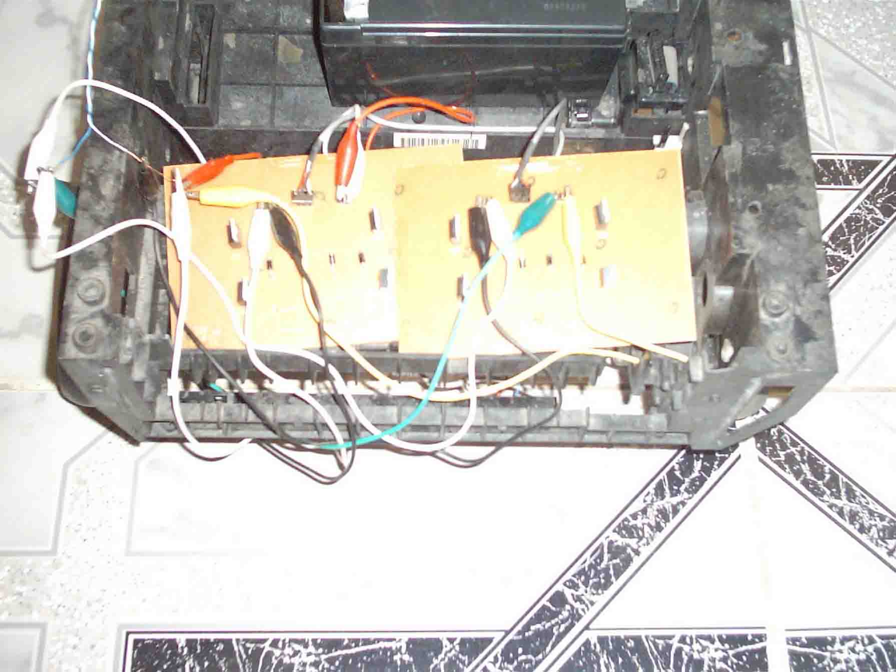

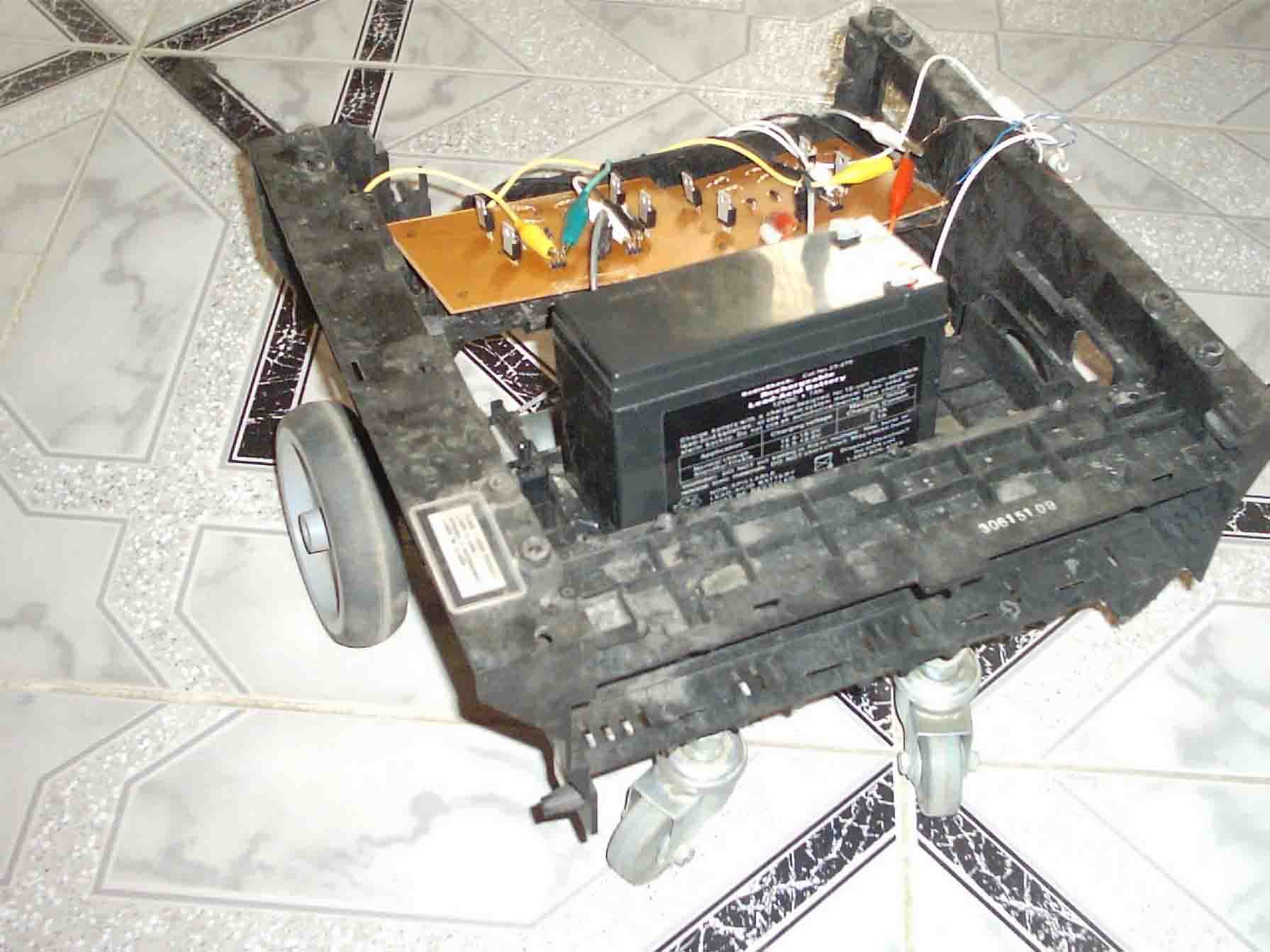

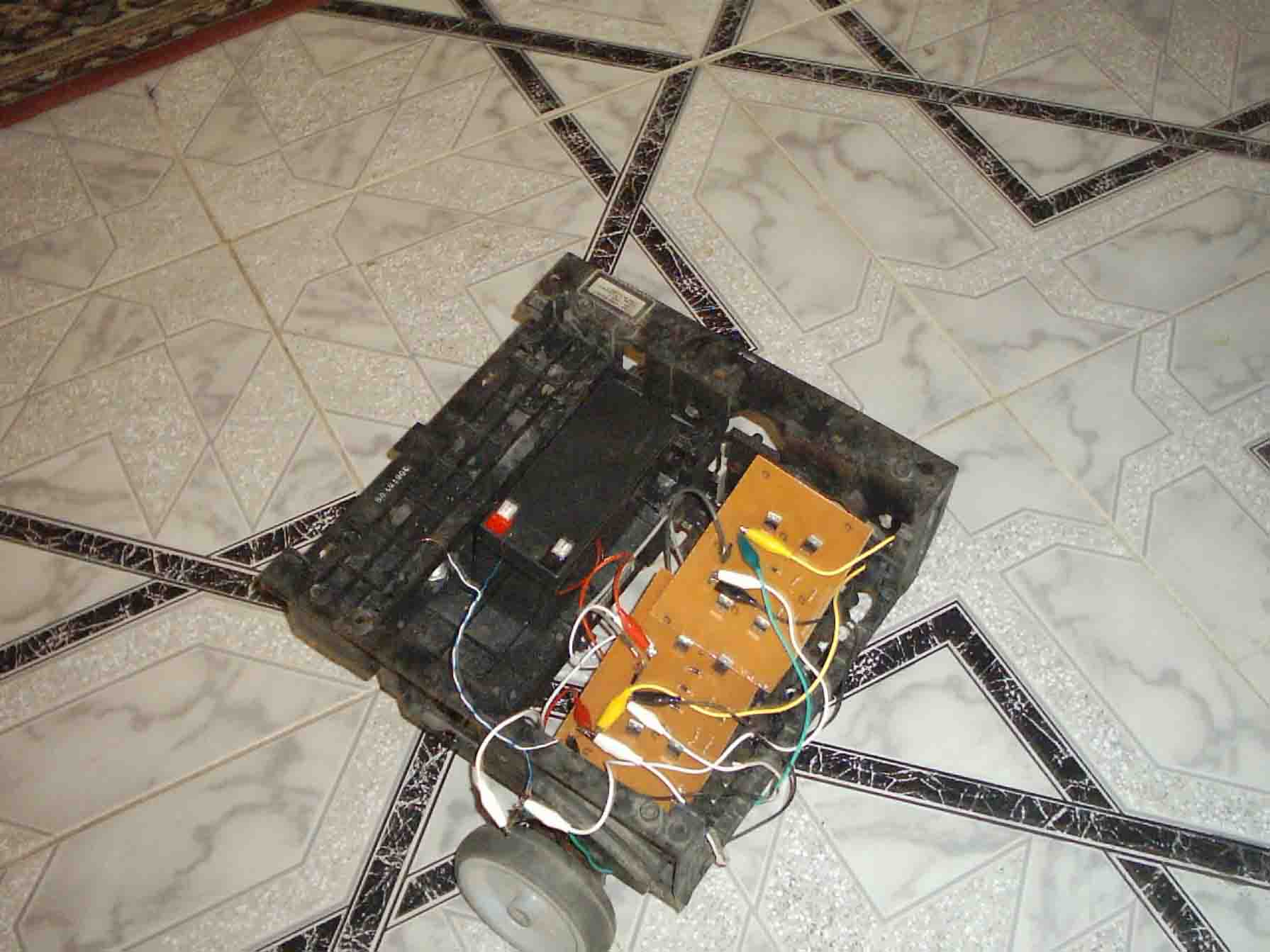

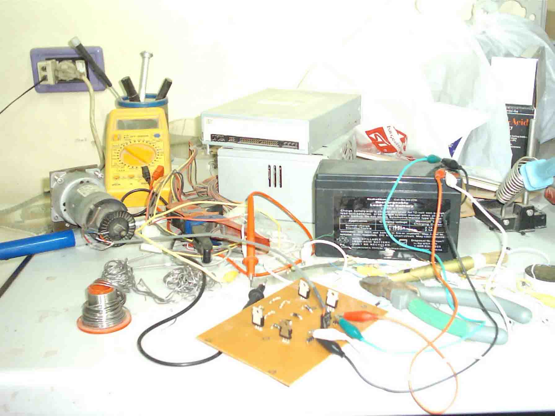

Here some photos for my work.
i'm actually working hard to finish it in a suitable time..... but still too much to do
sure i'm waiting for more comments

Lookin Good! All you have to do now is to make a more perminent body for it. Good job!
