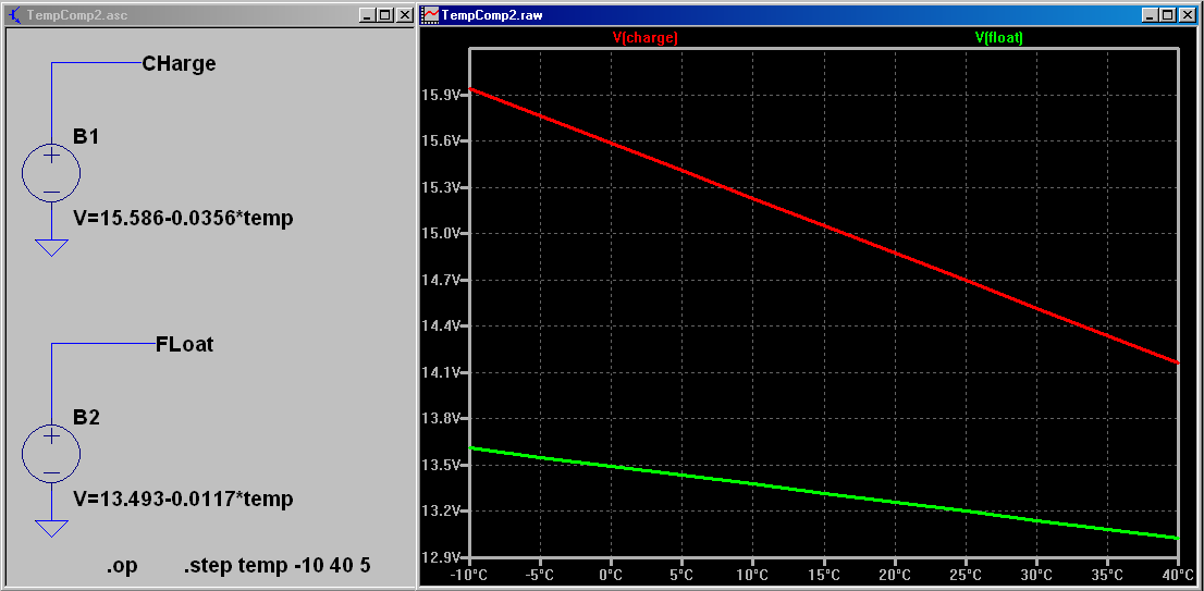

The data for temperature dependence of the FLOAT and CHARGE voltages came from Dr Mark's web site, here . The attached sim shows the required temperature correction coefficients for a 6cell battery in the behavioral voltage sources, and the plots show the temperature dependence.

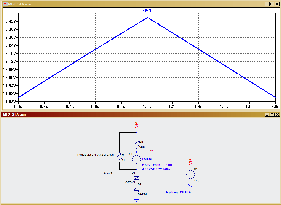

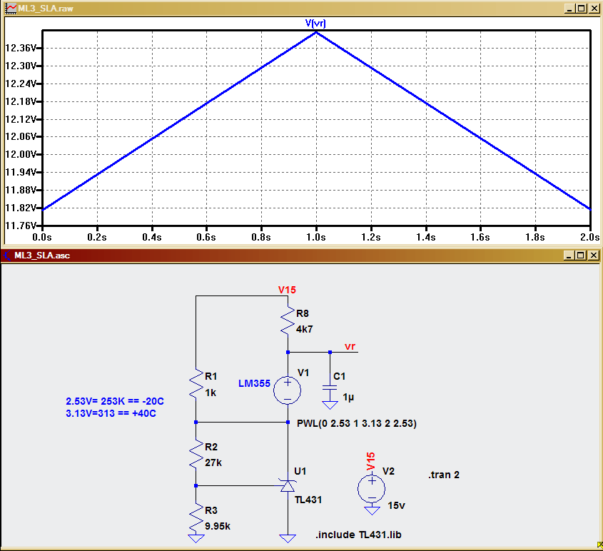

hi Mike,
I guess you have already dropped the zener from the previous circuit and opted for a TL431.
Another option.
