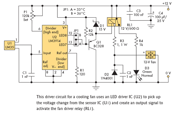

Try this:
Also look at my attachment for complete schematic.

I looked, but couldn't find any ramp rate or dwell timing function. Couldn't find a phase-control power regulator either. Just looks like a simple bang-bang controller module.
