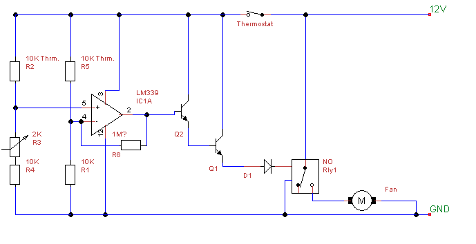

Proposed schematic
I just downloaded Tiny CAD and drew the attached diagram. Please critique:
  • Is the diode (D1) in the right way around? :)
  • Should the variable resistor (R3) be on the plus input or the minus input of the comparator?
  • What is a good value for the feedback resistor? (R6)
  • What would be the right power transistors (Q1 and Q2) to use for a 12V relay with a coil drawing 100mA or less?
  • Do we need a Darlington pair or would one transistor be enough to drive the relay?
Thanks,
Scott​
  • The protection diode needs to be across the coil, not in series (cathode to the plus relay connection, anode to the minus connection)
  • A thermistor resistance goes down with a temperature increase. Thus the way you have R3 connected will cause R2 to cause the comparator trip point to be when it is at a lower temperature than R5.
  • R6 needs to go to the + input for hysteresis, not the -. It's value depends upon how much difference you want between the fan off and on temperatures, and how much resistance change in R2 and R5 that corresponds to.
  • You need a resistor at the output of the LM139 to the +12V. The LM139 has an open collector output and can not source output current. 1k ohm would be a good value. Also add a 100 ohm resistor in series with the base (to provide a higher voltage delta for the hysteresis signal).
  • With this value of output resistor you would only need one transistor to drive a 100mA relay. But the relay coil should be placed in series between the +12V and the transistor collector (no other connection to the transistor collector). The transistor emitter then goes to ground.

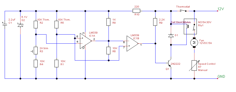

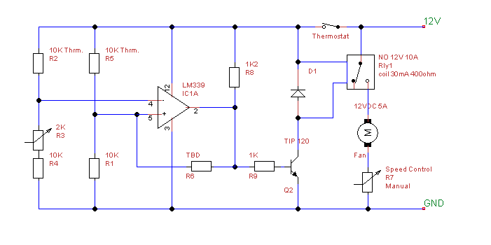

The 1K output resistor for LM139 at +12V is too low a value. The current is +12mA.
The LM139 datasheet gives output Vsat @10mA at around 0.8V and is even higher at 12mA, so a relay drive transistor might not turn OFF properly.
I would recommend to use a 4K7 resistor instead.
Another design
I found a design (with a schematic) for an LM339/thermistor-based thermostat controlling a relay: **broken link removed** by Bill Bowden and have tried to adapt it as a differential controller along the lines of Dean's design. Bill's approach also uses a Wheatstone bridge with a variable resistor but it gangs two of the comparators and drives them with 5V instead of 12 with a Zener diode regulating the power.
I have attached both my updated version based on Dean's design, as interpreted by Carl and others here, plus my adaptation of Bill's design based on what I have learned from you all.
I would appreciate any corrections, advice and especially an explanation of the advantages and disadvantages of each approach.
