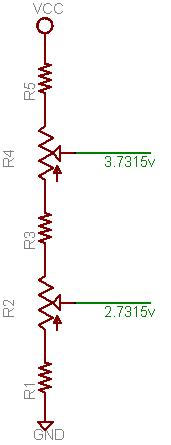

just a tip for you, one easy way to make the math for the temp sensor simpler is to use a resistor divider tree, with two potentiometers and 3 resistors, and use that to set the + and - Vrefs for the ADC input (to the two Vref pins on the PIC)
For mine, I set the - reference to the voltage representing 0 degrees C, and the + reference to the voltage representing 100 degrees C, if you want higher temp range adjust those voltages accordingly.
then your ADC value will represent the full range of temperatures you have chosen, instead of having a huge offset of 2.7 or so volts for zero degrees and severely limiting your resolution (in mine, I have the ADC's 10 bits spaced across 1 volt, instead of 10 bits spaced across 5 volts)
it also makes it easy to calibrate, because you can stick the sensor in ice water and adjust the lower pot so the PIC just reads zero, and then stick it in boiling water and adjust the upper pot until the PIC just reads maximum. (0x02FF or 0xFFC0 depending on your left/right justification)

Just a word of warning, check the PIC datasheet for details on possible loss of accuracy when using Vref far from 0V and 5V.
Secondly, don't set it for 0-100 degrees full scale, set it for 0-102.3 degrees, that way you don't have to do any maths to display it, it's already correct (except for manually adding the decimal point). This may be what evandude ment?, having to convert from 1023 to 1000 is rather pointless, and ruins the nice 0.1 degree display resolution.
Actually nigel I hadn't thought of that. Since the project I was using the sensors for was only to turn computer fans on and off, I wasn't very concerned with accuracy so I was only taking the most significant byte of the A2D result anyway... but doing zero to 102.3 is certainly a great idea when you have to display it!
