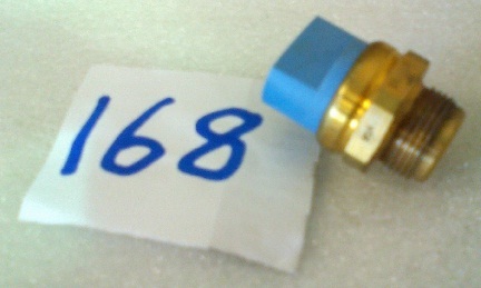

A typical fan switch closes when it gets to around 200 deg F. As stated I’m looking for a solution that opens around 90 – 100 deg F.
Go look on Ebay plenty of 12Vdc adjustable temperature controlers for around $15.
When entering Ebay you need to try diferent combinations of wording to find what you want.

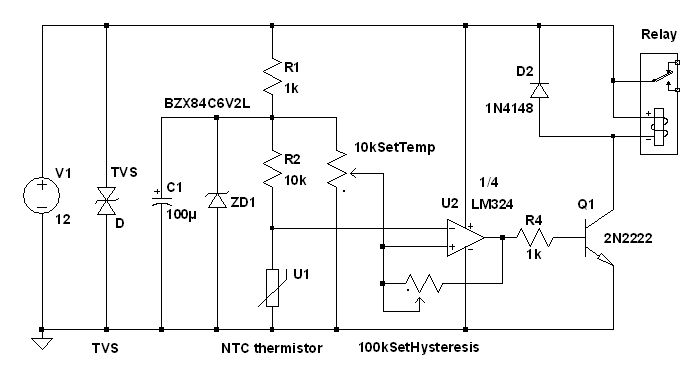

If you want a versatile switch you could build something like this:
This would give you control over both the switching temperature and the hysteresis (the difference between the open and close temperatures). You would need to epoxy the NTC thermistor into a suitable housing to make the temperature probe, but it sounds as though you have the facility to do that.
I would run with the circuit Alec posted. Simple and adjustable.
