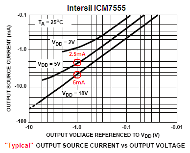

Only Intersil shows a graph of the "typical" output current.
With a 5V supply the sourcing output current into a dead short is only about 7mA, not more than 100mA like a "normal" 555.
With the 5V supply and a 1V saturation voltage loss the sourcing output current is only about 2.5mA.
With an 18V supply the output current into a dead short is trying to reach only 40mA but then the IC smokes and burns.
With a 5V supply the ICM7555 typically sinks 40mA into a dead short. With the 5V supply and a 1V saturation voltage loss it sinks 18mA.

You're right, I didn't look at the datasheets carefully enough.

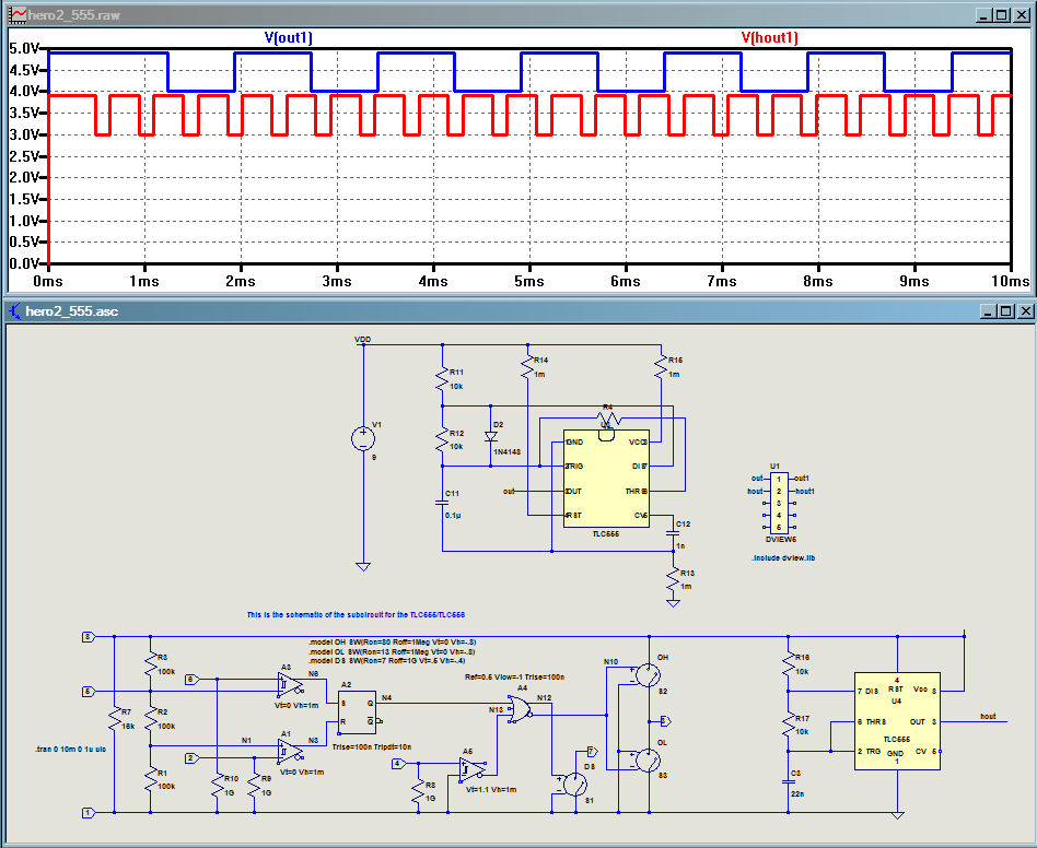

  • 555 test.asc
I have copied your listing, I'll give it ago, dont forget I'm still learning LTspice.:)

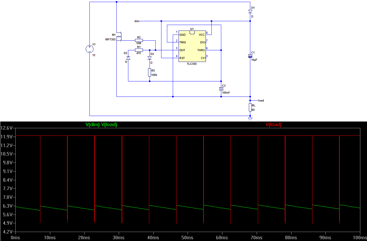

I've simulated the circuit with the ugly model, I hope you can see what I mean: the schematic in my first post is easier to read because of the pin locations on the IC.
It now works up to 99.5% duty cycle with a 200mA load with the TLC555 model.
I reduced the 100µF down to 10µF and it works fine.
One thing I've noticed is that the model has a setting for Vdd. I don't want to have to set it, I want it to be the voltage on pin 8. I ran the simulation, measured the approximate voltage across the 555, changed Vcc to the appropriate value and re-ran it.
  • TLC555dim.asc
I've RTFM for the TLC model and it seems like the value of Vdd is only used to calculate the output MOSFET on resistance which varies with the supply voltage.
It looks I'm doing it the right way, run the simulation, find out the supply voltage, run it again, paste the calculated supply voltage into the model's properties box and run it again and paste the newly calculated supply voltage into the properties box. The second guess is always pretty accurate.
The on resistance only matters when R1 or R2 are set to low values, when they're both 50k, it doesn't make any difference.

This is how I tried it, you must include the sub circuit.
  • hero2_555.asc
Yes, it works.
I hope you agree, that the schematic is much easier to follow now.
