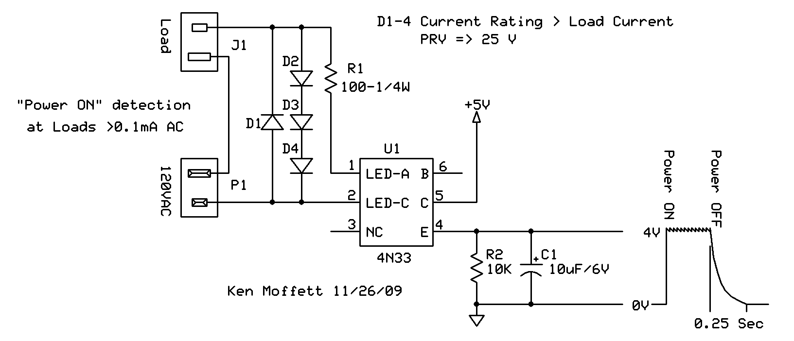

Now my next problem is, the DUT output will be mains voltage (AC) I now need some way to convert to 5VDC so I can feed into my PIC & an LED, as I need a visual indication and I need the PIC to time the output to make sure the DUT is timing correctly.
Is there a simple circuit that could handle all 4 voltages?? or am I going to need to design 1 circuit per DUT output voltage ??? by the way if the first option, would I need any relays from DUT ??? just a thought.

What about if I was to adapt this **broken link removed**, may be make 3 of them as the 12VAC will be an easy one with a rectifier and a 7805. I would also use an opto isolator as well so that I can keep the mains voltage out of my low voltage side.
And yes I have read the warnings on this page as well, I am well aware of the dangers of not having a transformer to split the circuit up.
Please don't use that supply. It's "intrinsically" unsafe. Since you're in an industrial environment, the government and lawyers will have a field day with you should anyone get injured. Go out and buy a separate transformer-isolated, regulated 5VDC power supply. If you really need to do it cheap...I get 5vdc/1A switch-mode power supplies (cell phone chargers) at Goodwill for $0.99USD. ;)
As for the output detector, I think the attached should do it for you. The "120VAC" input would got to the output of your timer output. The "Load" would go to the relays that select you lamps. It will work for anything above ~3VAC. The taper-off of the "Power-Off" indication can be reduced a little by reducing R2 or C1 a little. But that will increase the ripple on top of the ON signal. Since that time period is constant, I would just have your µC subtract it for the displayed reading. But, that short period may not be significant to your timer's spec's.
