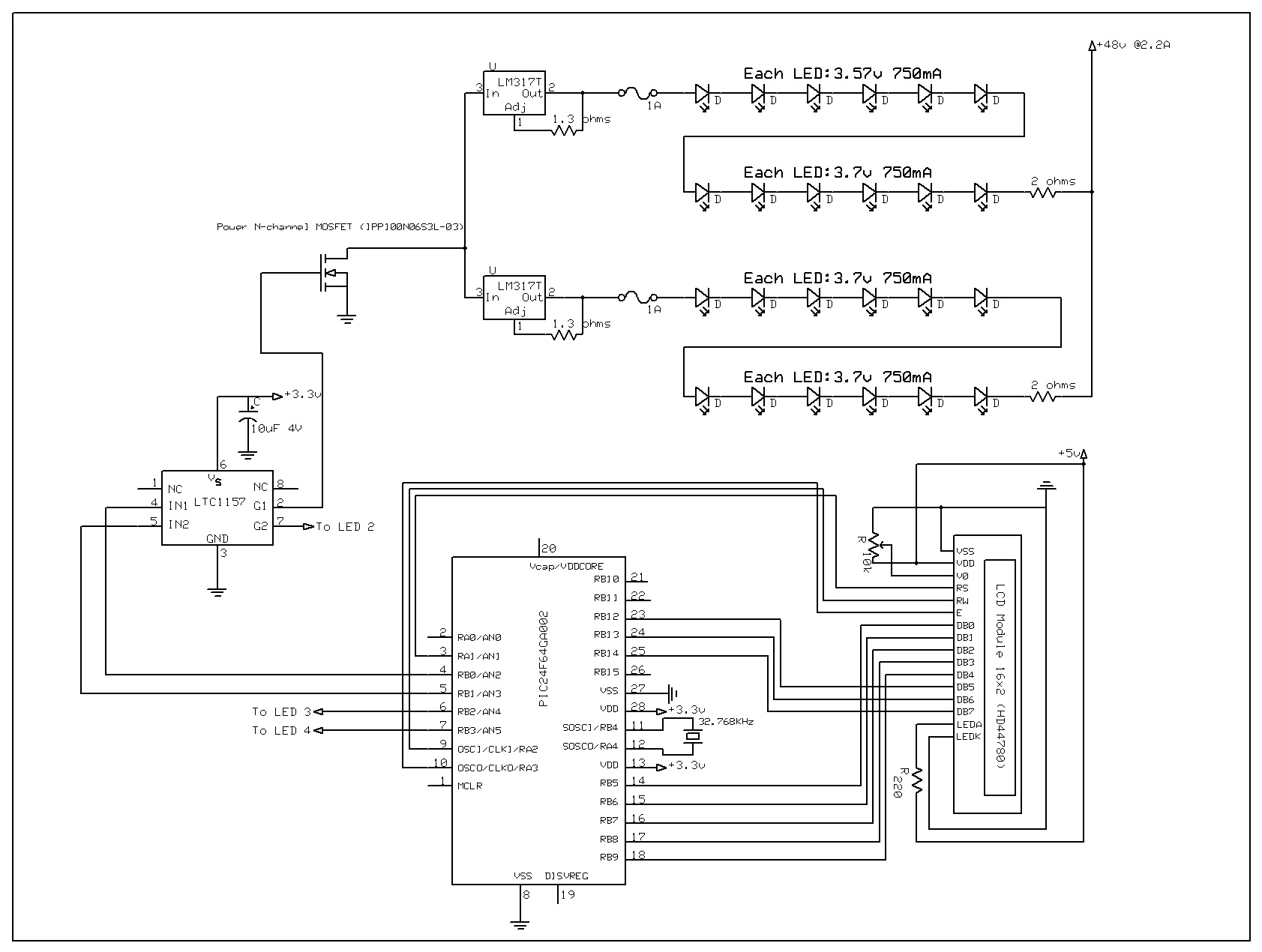

I have a PWM circuit which will run 24 high power leds. However I would like to test the circuit without blowing $8 per led.
The circuit runs from a ltc1157 into an N-Channel Power MOSFET. The ltc1157 is outputing ~8.7V so it is working correctly.
The model number for the MOSFET is IPB100N06S3L.
I am also trying to see if this is the correct MOSFET. Anyone know a good MOSFET tutorial site?
I have attached the final diagram.

I dont want to be unkind, but there is so much wrong with your circuit that I dont know where to start...
Are you a devotee of "electron current" by any chance?
First, the LEDs are all backwards. The +48V should feed the anode end of the LEDs, not the Cathode. As connected, you would indeed blow up some expensive LEDs.
The LM317 constant-current sinks are backwards, and miswired. The terminal marked "in" should be connected to the fuse, and the terminal marked "out" should just connect to one end of the 1.3Ω, the other end of the 1.3Ω ties to "adj" and to the drain of the big NFET. btw- are the 317s on a heatsink?
The LT1157 and NFET looks ok, however you overkilled the current spec on NFET (100A), super low RdsON, but shortchanged the Voltage rating (only 55V for a 48V supply).
What is the forward drop on your leds at 1A of current?

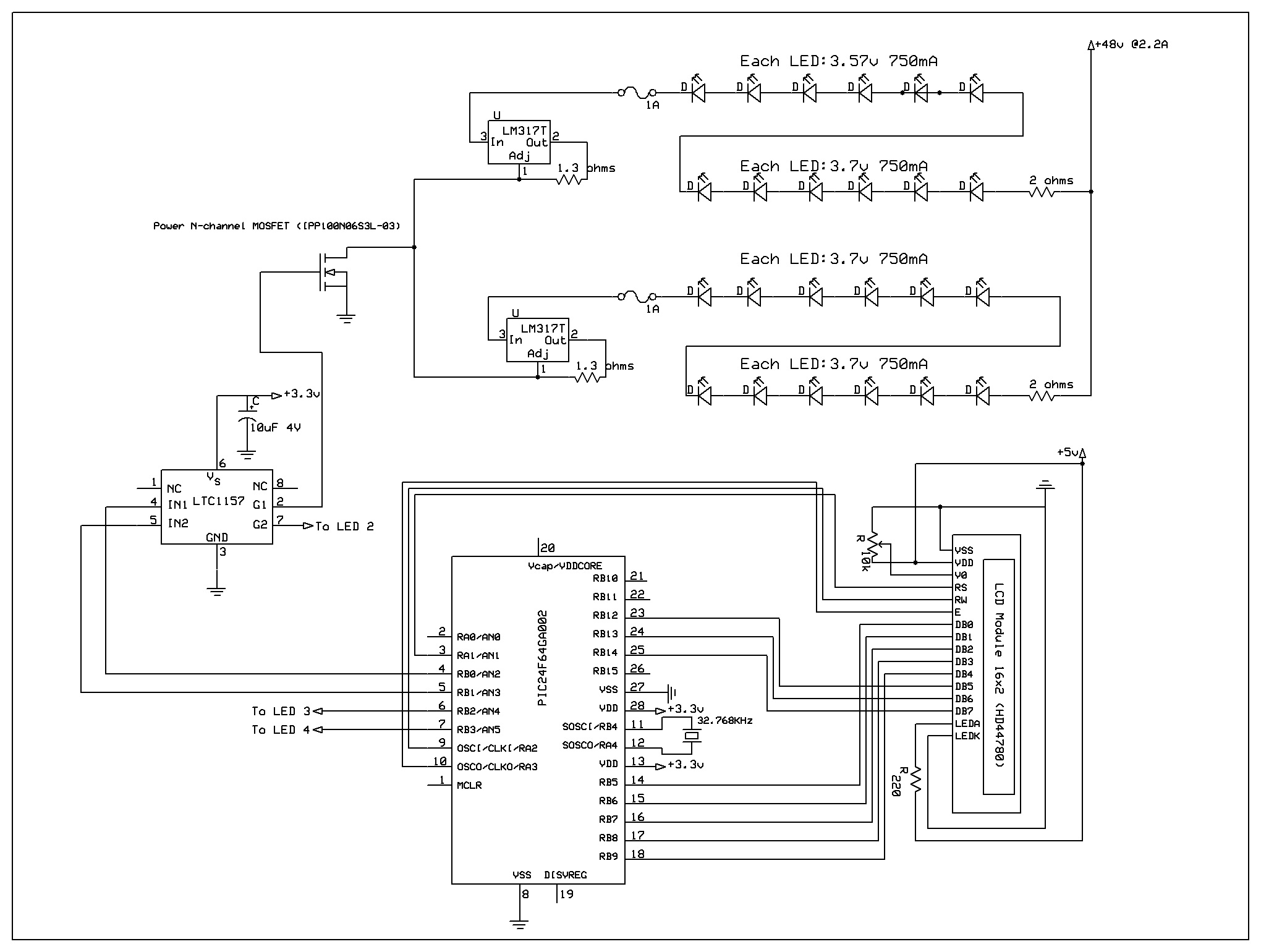

I adjusted the diagram to take into account your comments and attached the new version.
I have not built that part yet, but judging on your comment, I am guessing they should be.
I had a hard time looking for the correct NFET. I did not know which to use and then I was not sure if I needed a LT1157 or not. Can you suggest a different FET?
3.7V

Ok, at 3.7V per LED, times 12 LEDs is 44.4V, so starting with 48V, you only have 3.6V left over. That is just enough for the LM317 to work as a current limiter if you get rid of the 2Ω resistor.
The dropout voltage of the LM317 is 2V at 1A, plus the drop across the 1.3Ω resistor is 1.3V, for a total min drop of 3.3V, so you will have only 0.3V of headroom for the LM317 to do its constant-current magic.
At 1A of LED current, the drop across the LM317 will 2.3V, so it will be dissipating 2.3W. Which package are you using? The TO220 package with no heatsink is spec'ed at 50degC/W, meaning that it go into thermal limiting. You will need to get a heatsink on it which will lower the thermal resistance to under 30degC/W...
