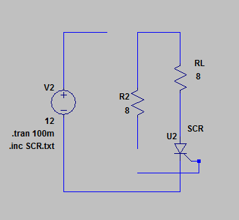

I have drawn a very basic SCR circuit in LTSpice to see if I can get it working so I can work out the circuit required for the above, is there a way to add working switches in the program.
Or how to simulate the switches somehow, I need two switches for the gaps in the circuit?
Circuit attached
Cheers

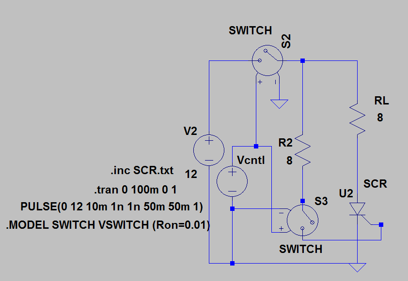

I have worked the switches out in LTSPICE, now to the circuit.
Some advice would be greatly appreciated.
Cheers

No you have it correct, the SCR will switch DC. One thing to remember is that on an SCR, what turns it off is when the voltage between the anode and the cathode falls to a low value it turns off. So on AC when the AC voltage is near 0 the SCR turns off. On DC removing the DC voltage will turn if off, or reducing the DC voltage to the turn off potential. A small voltage between the gate and cathode turns them on. Some SCR's have a gate current limit so a current limiting resistor is a good idea. Your first posted circuit is the best to use.
Connect the R2 load resistor to ground, not to the SCR gate.
Connect S3 from the SCR gate to the output of S2 through a suitable resistor (to give the required gate trigger current for the SCR gate).
Then switching on S2 will apply load R2.
Momentarily closing S3 will trigger the SCR and add load RL.
Opening S2 will remove both loads and reset the SCR.

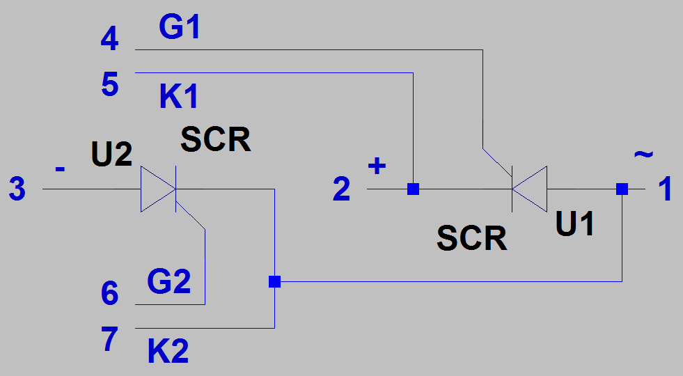

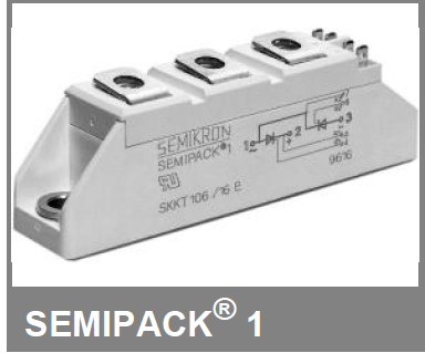

Thanks for the replies k7elp60 & crutschow,
I have a couple of questions.
Should I have some protection for the SCR as in a snubber diode etc?
The big SCR that I have (mentioned above) is largely overkill for this application but I have it & will use it. Looking at the internal diagram drawn on the SCR itself, this is just two SCR's in series, is that correct?
I have attached a picture of the internal connections & another of the SCR itself.
On the base of it, it has terminals 1 to 7, 4 & 6 are the low voltage Gate connections.
Now with the main terminals 1, 2 & 3, do I have to Bridge terminals 1 & 2 on the base.
Pin 3 is the output.
Cheers
