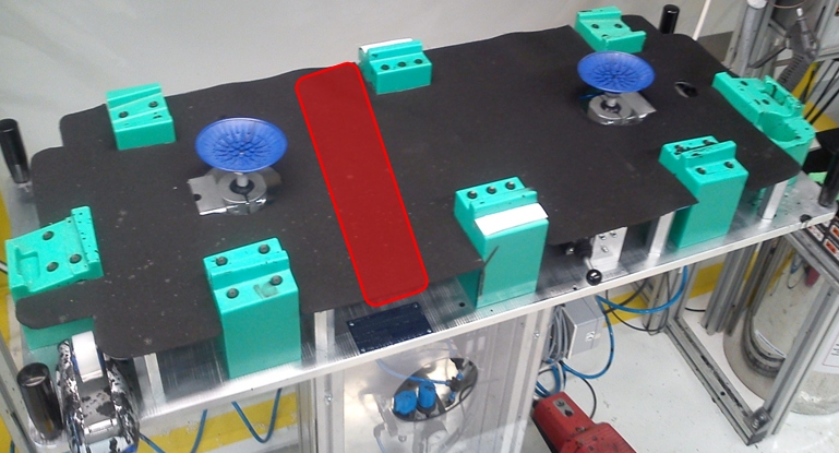

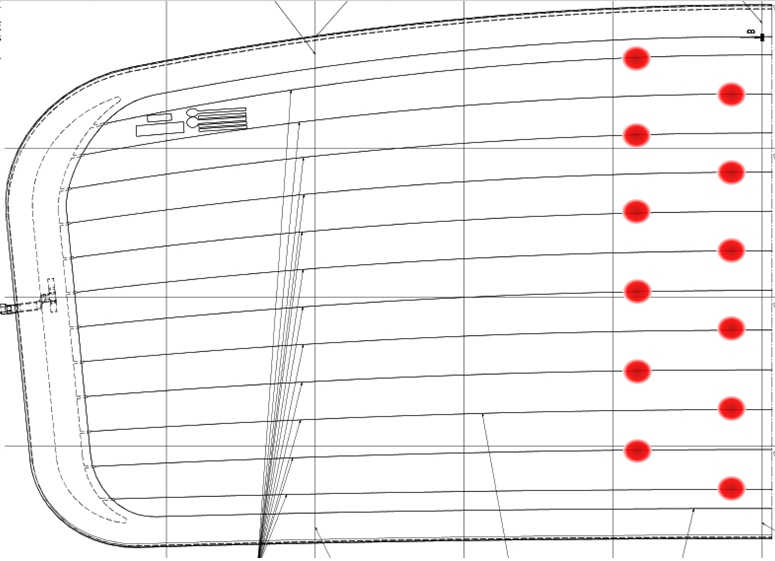

In the attachment you can find the tool used for window checking and cleaning and technical drawing of the window, I placed red dots where I would place the sensors.
I would like to try to use digital hall effect sensors (0 if no current, 1 if any current) because this seems the fastest, the most accurate method and could be easily automated and evaluated with PLC. Could you recommend any appropriate sensor, small and sensitive enough? (current in each wire ~1A, measuring distance >2mm) I have 4cm gap between the window and the tool if I place window into that. Would it be better to use lower voltage or use AC power instead of DC 12V?

Under low pressure, you could find discontinuities with HV (e.g., small Tesla coil), but I think a Hall sensor, either analog so you get an idea of the amount of current of binary/digital as you suggest, would be far better and faster.

A simple aproach would be to use a linear o/p hall effect sensor and detect the magnetic field around each conductor, assuming they are far enough apart to discriminate one from the others.
The sensing distance is greater than 2 mm. I've used Hall sensors with magnets, but not just laying one up against a single conductor. I'm sure the fine people at Allegro semi can help you determine if one of their parts will work.

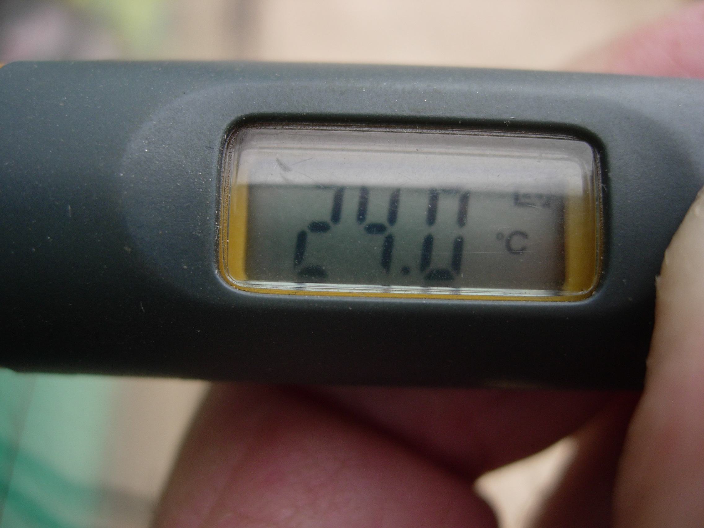

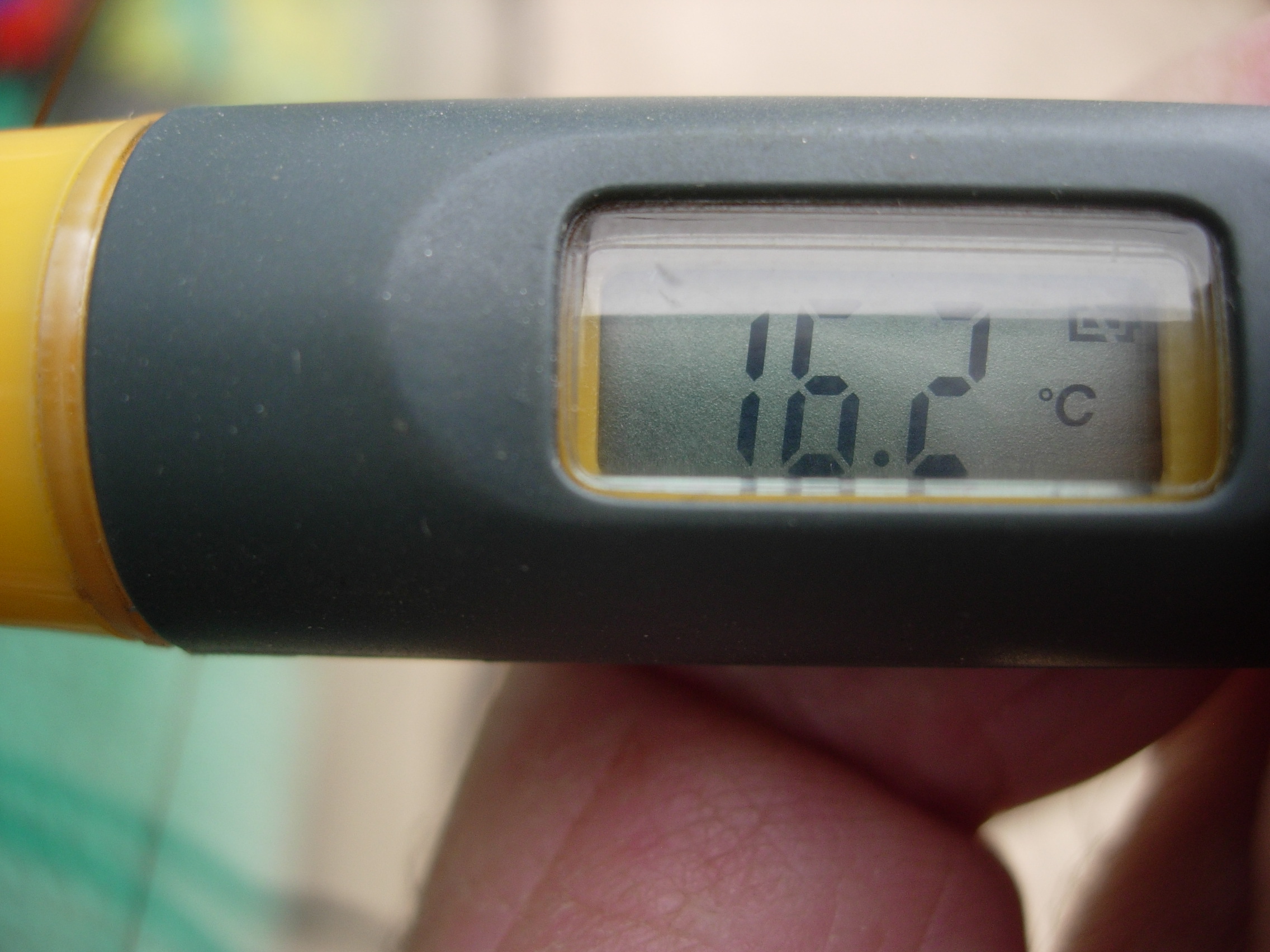

Very simple using a cheep Infrared non contact thermometer, took about 2 minutes to find the faulty strip on my vehicle from start to finish. Before all the glass heats up there is a large difference in the temp of the strips. I was using the thermometer on the outside of the glass & touching the glass & just sliding it up or down. Use in the middle of the window.
