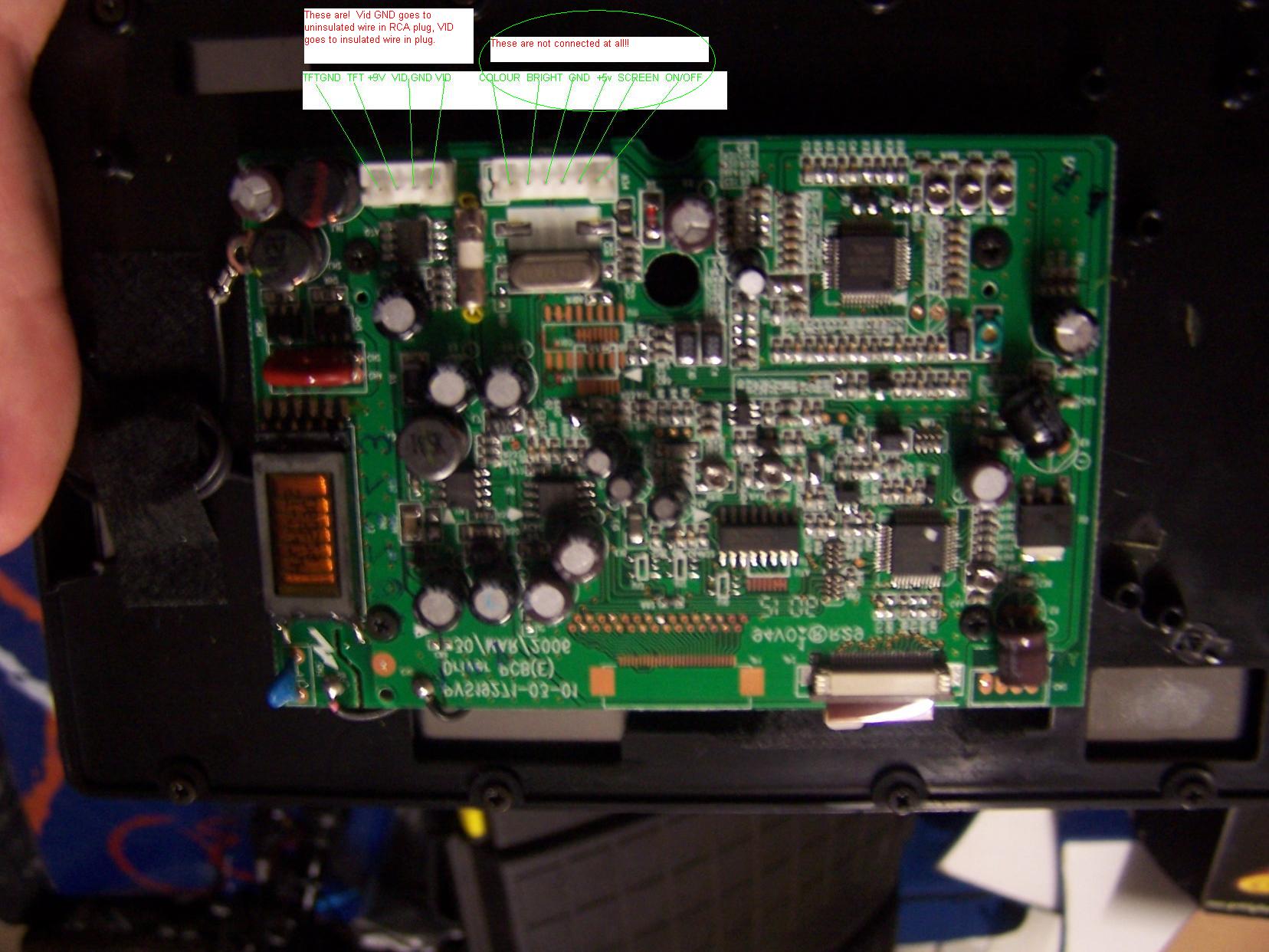

I have a small TFT screen here, WITH the driver board. The driver board has 2 connectors on it. The first connector has: ON/OFF, SCREEN, GND, BRIGHT and COLOUR.
The 2nd has: VIDEO, TFT +9V, VIDEO GND and TFT GND
I am confused to what inputs go where, before I noticed the 2nd connector I thought SCREEN was the video input, but that seems wrong now. Most of them are pretty self explanatry, but I am stuck on what I need to feed into SCREEN, BRIGHT and COLOUR.
I have a feeling SCREEN may be for widescreen/normal mode selection, but I wanna ask before I blow anything up :D
EDIT: I am assuming it's just composite video input.

I have a part number for the TFT driver board. I tried google but got nothing, but: PVS19271-03-01
I'll get a pic of it really quick...
Big pic, but you cant see anything without it big ;)

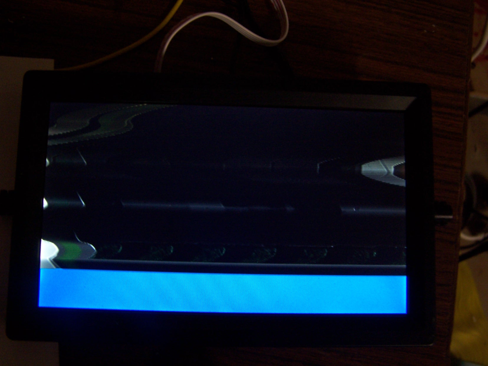

It's working!! Well, kinda. Now I appear to be having that problem where the picture is VERY distorted and runs up and down the screen. i think its a display format (PAL and that stuff) problem, but i'm not 100% sure if it is, or how to fix it. I think the display is PAL.
EDIT: Fixed it!!!
Turns out I had a bbbaddd interference problem! :eek:
