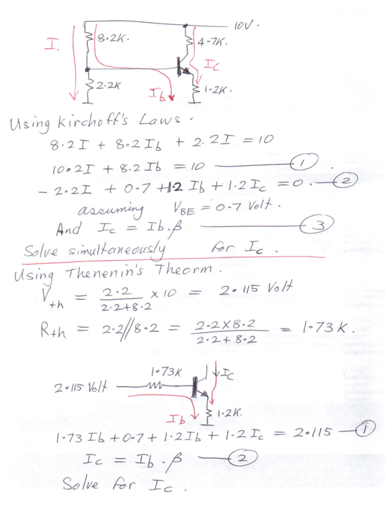

Here is an example of how Thevenin's theorm makes the maths easier.
Using Kirchoff laws leads to 3 equations and 3 unknowns.
Using Thevenin leads to 2 equations and 2 unknowns.

Just be careful that the Thévenin equivalent refers to what user do at terminals A & B and said nothing about what inside the black box.
As far as any user measurement or loading is carried out at terminals A & B, the blackboxed circuit and the Thévenin equivalent circuit will appear to perform the same and it can not be distinguished. However, in real life the circuits are different.
For example, the blackboxed circuit could be heating up 100 times faster than its Thévenin equivalent.
