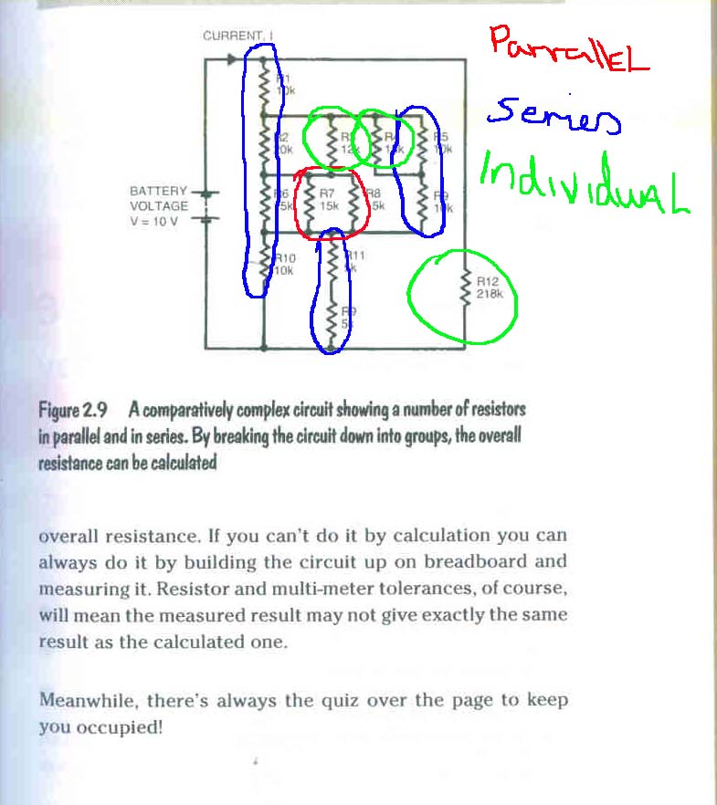

Just one other question that has me a bit confused. The diagram in the attached file shows a circuit made up of a battery 10v and a number of resistors and the question is to find a value for I by finding the overall resistance but before I can do that I have to decide which ones are in series, parallel and individual which is where I'm a bit stuck as some could be but in more than one category. You can see from the diagram which ones I've chosen was wondering if my choice was correct and if so, if I follow the rules for finding resistance for the individual groups of resistors and sum up my answers and apply ohms law I should come up with the correct value for I right ??

There are couple of mistakes in your parallel and series grouping. You can't calculate R5 and R9 in series because there is the resistor R4 in parallel with R5.
I would say that there are no "individual" resistors in that schematic. Every resistor is in parallel or in series with another resistor or a group of resistors.
First calculate:
Parallel:
R2||R3
R4||R5
R6||R7||R8
series:
R11+R? (can't read the number of the resistor below R11)
After you calculate those values, it is a good idea to redraw the diagram by replacing the parallel and series groups with the calculated values.. and then find new parallel and series groups etc.
only the middle blue one can be done first(out of order) this is because it is truly series,, the other 2 blue ones are actually series parallel networks which must be simplified first

ok,,, for now use 1/rt = 1/r1 + 1/r2.... to calc your parallel resistors just to keep in a trend for now,
first you must note there are NO independant resistors there,,, as i go through the steps redraw your circuit each time to follow.//
our object here is to simplify, to do this we will first compress all parallel branches, as ron says do R1 and R2 first(parallel calc) dont forget ..... then add R4 and R5(parallel again) ......... then do R6,7,8 ........
NOW it is cleaner and we can add the series resistors,, so it s simple adding(for simplicity the answer you got for R4parallelR5 will be called R4,5 K?)..... so first we take R4,5 and R9 and add them(series), then we take R2,3 and add it with R6,7,8 AND with R1 aswell(series),, now adding R9 and R11 together will also simplify that branch.
lets pause here since you are wondering about adding R10 to that series part , and the reason we couldn't do that is cause R10 has a parallel branch with R9,11 but now since we have added R9,11 we can now take that answer and simplify the parallel with R10 , once you have that branch simplified THEN you can add it to the HUGE SERIES part we just did,,,
simplify...... at the end you will get a resistor(equivalent) in parallel with R12......:)!!!!!
