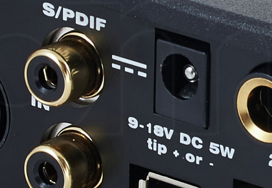

also here is the picture of the back of the soundcard, when its come to polarity on which side to i turn the plug?
A very good question.
The text on the soundcard says "tip + or -"
It could be that the designer of the soundcard anticipated problems with people making the wrong connection and damaging the card.
So he spent an extra $0.5 and included a rectifier so that the polarity does not matter, it will work either way around.
